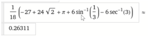

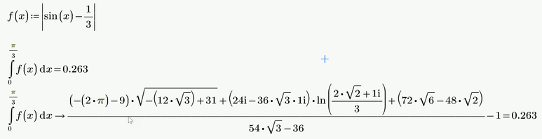

Why SMath studio does not give at least the correct result which is 0.263 for this integral?

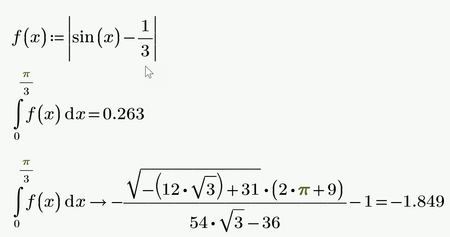

Mathcad Prime 10:
-1.849 result is comming from symbolic result calculation, which is wrong in this case, but numeric result 0.263 is correct here also in mathcad prime 10.

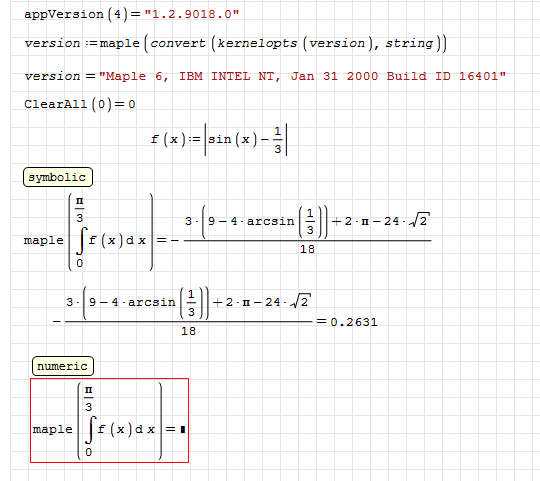

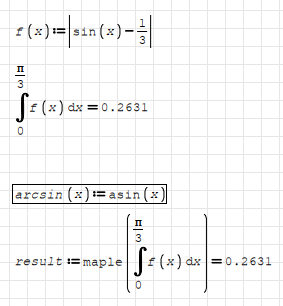

You must clear previous results (implicit definitions). If you do not, the task statement may change. To be sure, do each check separately in a new document.
maple-int-arcsin.sm (7,66 КиБ) скачан 1739 раз(а).
#4 Опубликовано: 14.10.2024 18:47:14

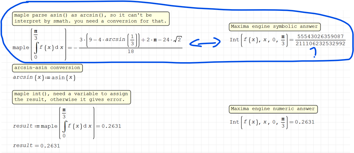

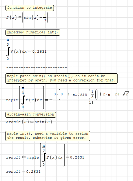

It gives correct results, even with embedded or maple.
You need to change arcsin() function to asin() however.

There may be different regional settings here. What you see as a plugin error is not always a plugin error. It may be an error in interpreting the results from the plugin or an error in the program itself. A little investigation is needed to clarify the details of the crime.

Could you post also the worksheet? As I do not know why my function arcsin(x) definition is not taken into account
Here it is, regards
int-embedded_maple.sm (6,97 КиБ) скачан 1727 раз(а).

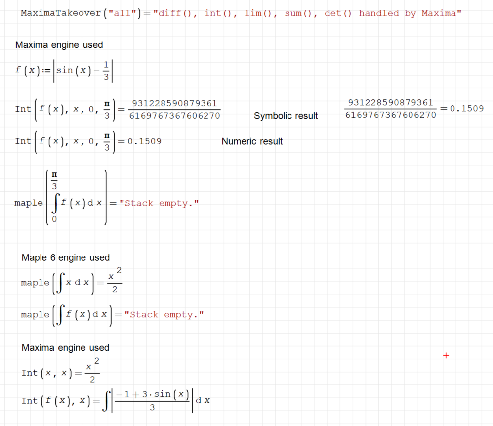

I see also the difference between Maxima engine and maple version 6 engine (in symbolic answer). With maxima engine the result is more a rational approximation of an irrational result. I would expected something similar as maple engine give when evaluating integral symbolically.
#13 Опубликовано: 15.10.2024 16:00:37

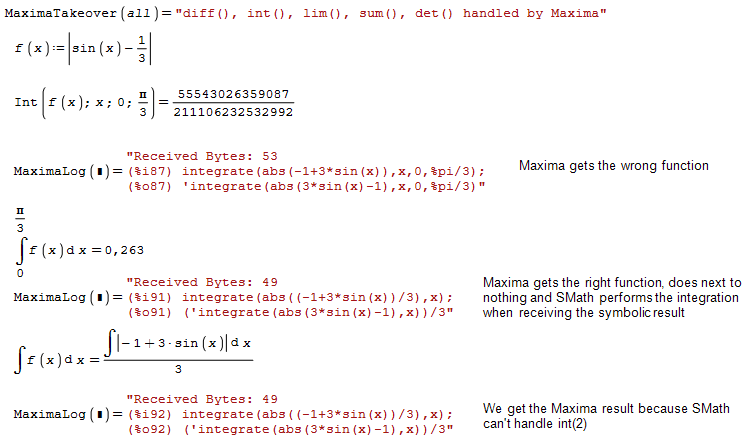

Maxima can't handle the integral. It returns a slightly modified symbolic representation. This is hidden by SMath postprocessing of the symbolic results (which doesn't seem to be suppressed for Optimization> None.
There seems to be a problem in preprocessing/translation when using the Int() function.
Worksheet20.sm (7,27 КиБ) скачан 1680 раз(а).
#14 Опубликовано: 15.10.2024 18:58:07
There is a load("abs_integrate)$ statement for these kind of situations.
If not used, maxima can't parse absolute integrals as I have understood.
https://maxima.sourceforge.io/docs/manual/de/maxima_181.html
It doesn't work on my linux commandline maxima however.
Possibly missing the module.
