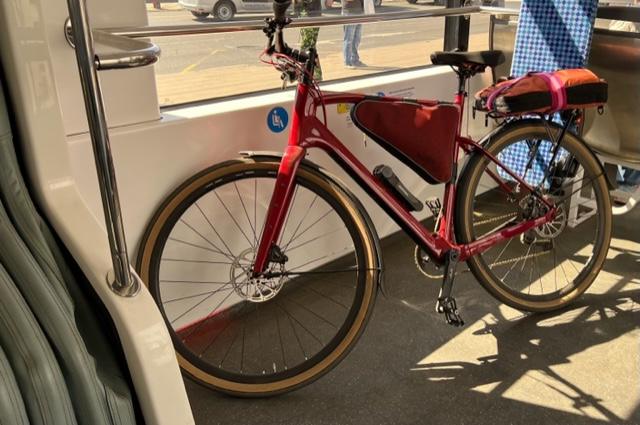

I would like to create one digital twice of my bike in SMath.
With seven instead of three gears and with a chain tensioner.
Help me please. The first step in attach.

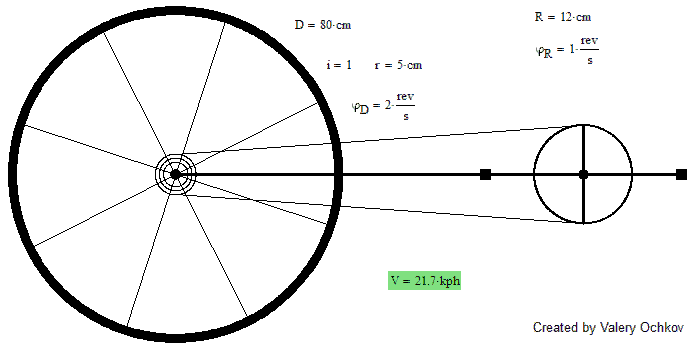

Your mathcad example can be done in SMath.
But I don't have the willpower to do it.
Here is the pdf for mathcad file.
And sm file without graphics.
Maybe there is a user who will help you.
bike_unleashed.pdf (61,38 КиБ) скачан 997 раз(а).
bike.sm (22,83 КиБ) скачан 1640 раз(а).

WroteI would like to create one digital twice of my bike in SMath.
4+3 gears.
bike.sm (22,27 КиБ) скачан 1613 раз(а).
