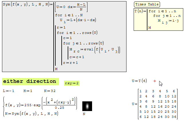

#9 Опубликовано: 24.03.2020 08:41:52
In this demo: Sym(f(x,y),L,H,N)
is my universal image algo creator, based internally on 'U'
which 'U' is set to '0' from any other existing creation,
whether vector/matrix.
