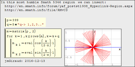

Writer region & hyperlink are all explained in their
respective release. What do you mean "run" ?
F9 calculates the all work sheet.

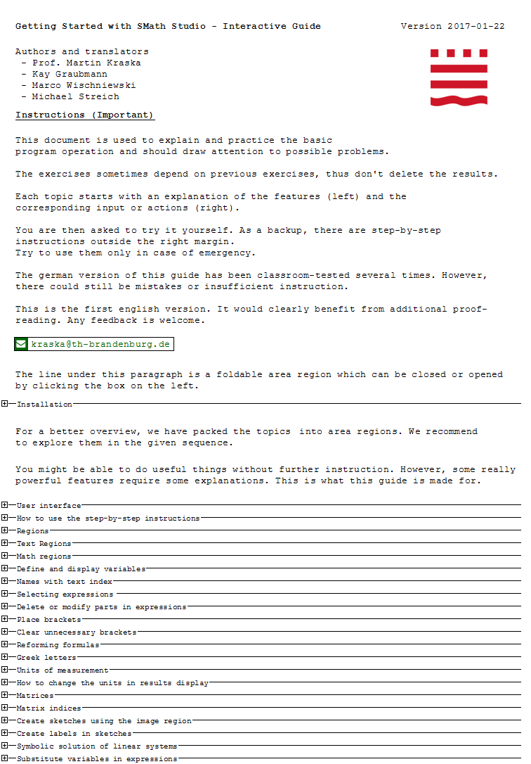

#7 Опубликовано: 02.01.2017 13:43:25
I uploaded an interactive (german) tutorial "Erste Schritte mit SMath Studio" to my support page. It is a single .sm file with 22 area regions (topics).
https://extmoodle.th-brandenburg.de/course/view.php?id=34
This perhaps could be distributed easily via the online gallery but I am not sure as what type of extension I should register the file.
- handbooks would require pdf or cbm format
- interactive books would be opened in the limited viewer window (the user of the tutorial is expected to perform exercises)
- example would work but is not really the right word for the stuff.
My recommendation would be to extend the handbooks type to accept self-contained (with no dependencies) .sm files.
PS: I failed to add the tutorial to the wiki list. There was an error when producing the preview.
Andrey Ivashov 09.01.2017 13:25:00, Davide Carpi 13.01.2017 10:05:00
#8 Опубликовано: 22.01.2017 21:21:34
The interactive tutorial has been extended with an english version. You can download it in the extension manager.
