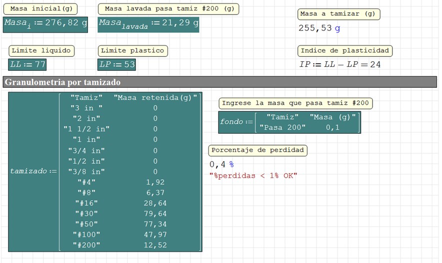

Attached is a spreadsheet to classify the soil according to USCS and the granulometric curve is plotted by sieving.
Please upload any improvements done to this file and post if any mistakes are found or if you have any suggestions.

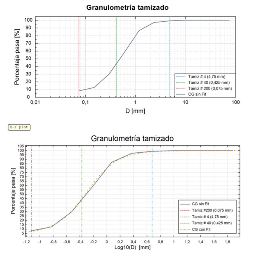

I added the logistic sigmoid function you made to the initial code and it compare with and without the fit. In addition to the initial curve, I graphed it using the Zed Graph, where it can be better appreciated using a semilogx graph
USCS-fit-Granulometry.sm (175,97 КиБ) скачан 1522 раз(а).
