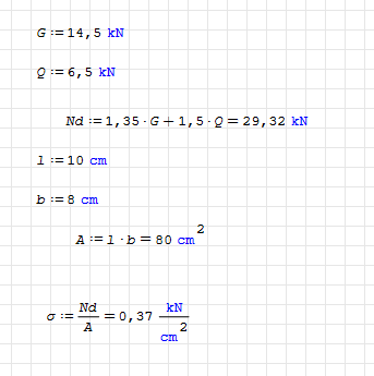

I cant Manage to define Units
I want to define, for example mm^2
I define 'mm^2:'mm^2 or 'mm^2:'mm * 'mm and i get a Syntax Error
If I Calculate:
A:3'mm
B:5'mm
X:A*B
I get:
X=1,5*10^-5'm^2
I would like to get
X=15'mm^2
Where am I going wrong?
As an constructive Ingeneer i need even more Units as
kN/m^2 or N/mm^2

I would start out by saying that you might want to read through some of the instructions first.
There is already lots of info about how to use SMath. This is a very basic part of SMath.
For your issue specifically:
After you define X:=A*B and press enter, it will produce the default unit of m^2
You need to click on the entry and you will see a second black units box after the default m^2 one.
Click in this box and then just type in mm, press tab to insert unit, then type ^2 to make it square.

You can change the units on any result by doing the same thing as long as they are equivalent units.
Good luck.

I might add that you need to press tab to insert each unit.
So for kN/m^2, you need to type in kN, press tab, then type / and then type in m and press tab, then type in ^2 to make it square.

Thaks a lot, now i got it....press TAB some More times...
