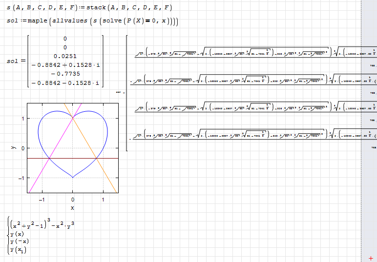

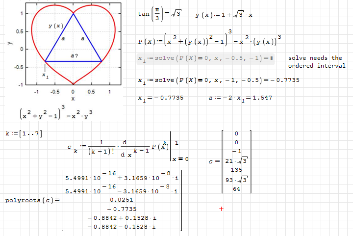

Hi Valery. It seems that solve doesn't know how to order the interval.
The 6 solutions numerically
And symbolically
solve(4).sm (158,3 КиБ) скачан 958 раз(а).

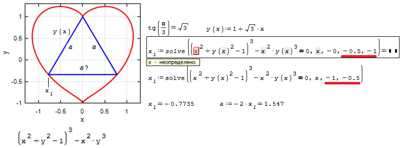

It is one task from the article
https://disk.yandex.ru/i/59sq-AYpKky-3Q

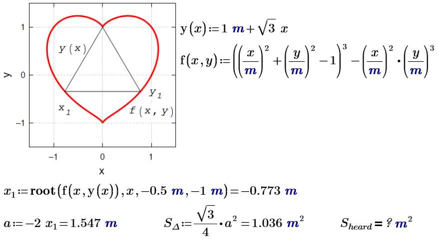

Do you know the best solution in SMath?

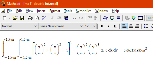

#5 Опубликовано: 25.07.2026 15:50:39
Hi Valery. Two ways.
heart area.sm (13,36 КиБ) скачан 901 раз(а).
Mathcad 11:
mc11 double int.mcd (4,77 КиБ) скачан 911 раз(а).
Отредактировано 25.07.2026 17:52:57

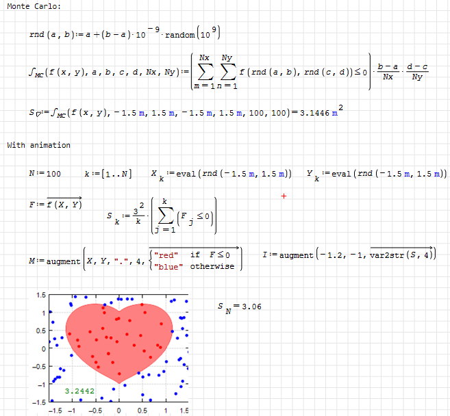

And what about this. We can create an animation.
Отредактировано 25.07.2026 19:47:21
#7 Опубликовано: 26.07.2026 02:28:14

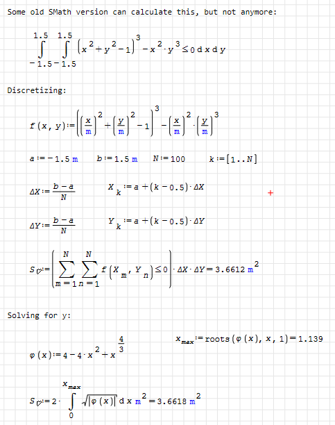

It's possible, although speed isn't one of SMath's main features. And with so few points, there isn't much accuracy.
heart area.sm (26,99 КиБ) скачан 893 раз(а).

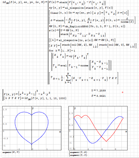

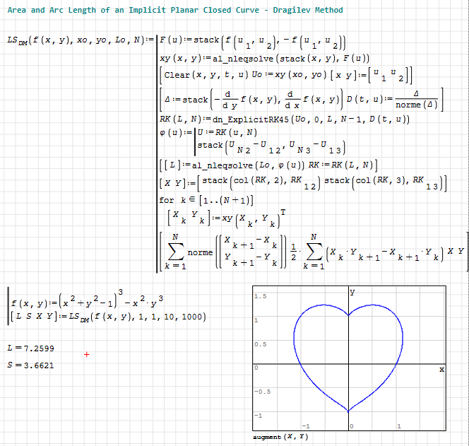

#10 Опубликовано: 27.07.2026 01:25:09
Using Dragilev Method.
Area and Arc Length of an Implicit Planar Closed Curve - Dragilev Method.sm (16,28 КиБ) скачан 915 раз(а).
Отредактировано 27.07.2026 01:33:24

#12 Опубликовано: 28.07.2026 08:24:46
Yes, something like this with the Gaussian area formula.
Hi Viacheslav. In that case, I'd like to point out that dividing by the norme (Δ) means the curve is parameterized with respect to arc length, and that if you're going to improve the points using the original function, you must also do so with the parameter variable, which in the program's notation is T. This is because Dragilev's method ultimately obtains the parametric expressions x(t) and y(t) from the implicit function f(x,y) when starting from a point (xo,yo) on the curve.
This is one way to correct the arc length given by T if you choose to improve the curve points, although there must be better methods involving splines for curves in the plane, not just single-valued functions. There are also better approximations for the area enclosed by the curve; the one used here is simply the area defined by a closed polygon.
Area and Arc Length of an Implicit Planar Closed Curve - Dragilev Method.sm (17,78 КиБ) скачан 397 раз(а).
Отредактировано 28.07.2026 08:36:40
