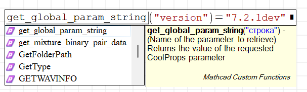

You can try Mathcad Custom Functions plugin
Links:
1. https://sourceforge.net/projects/coolprop/files/CoolProp/nightly/MathcadPrime/
2. https://www.smath.com/ru-RU/forum/topic/DaKGEh/Mathcad-Custom-Functions
Userefi path: %appdata%\SMath\extensions\plugins\91a20d24-c30b-4774-9b1b-4d502a80420f\1.1.8035.3236\userefi
You must copy CoolPropMathcadWrapper.dll there.

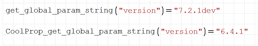

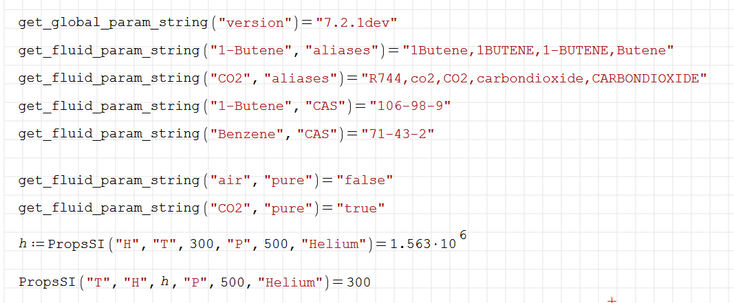

Final follow-up: I had some problems with my PC, which necessitated uninstalling and reinstalling and upgrading a lot of software. In reinstalling SMath and CoolProp, I followed Uni's instructions above and... it all worked!
If I use the Mathcad Custom functions format ("get_global_param_string("version")), I see the installed version of CoolProp;
if I use the CoolProp wrapper format ("CoolProp_get_global_param_string("version")), I see the older version of CoolProp.
