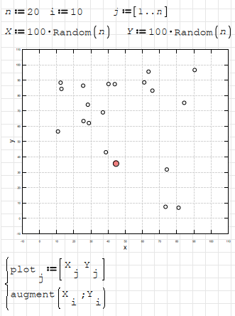

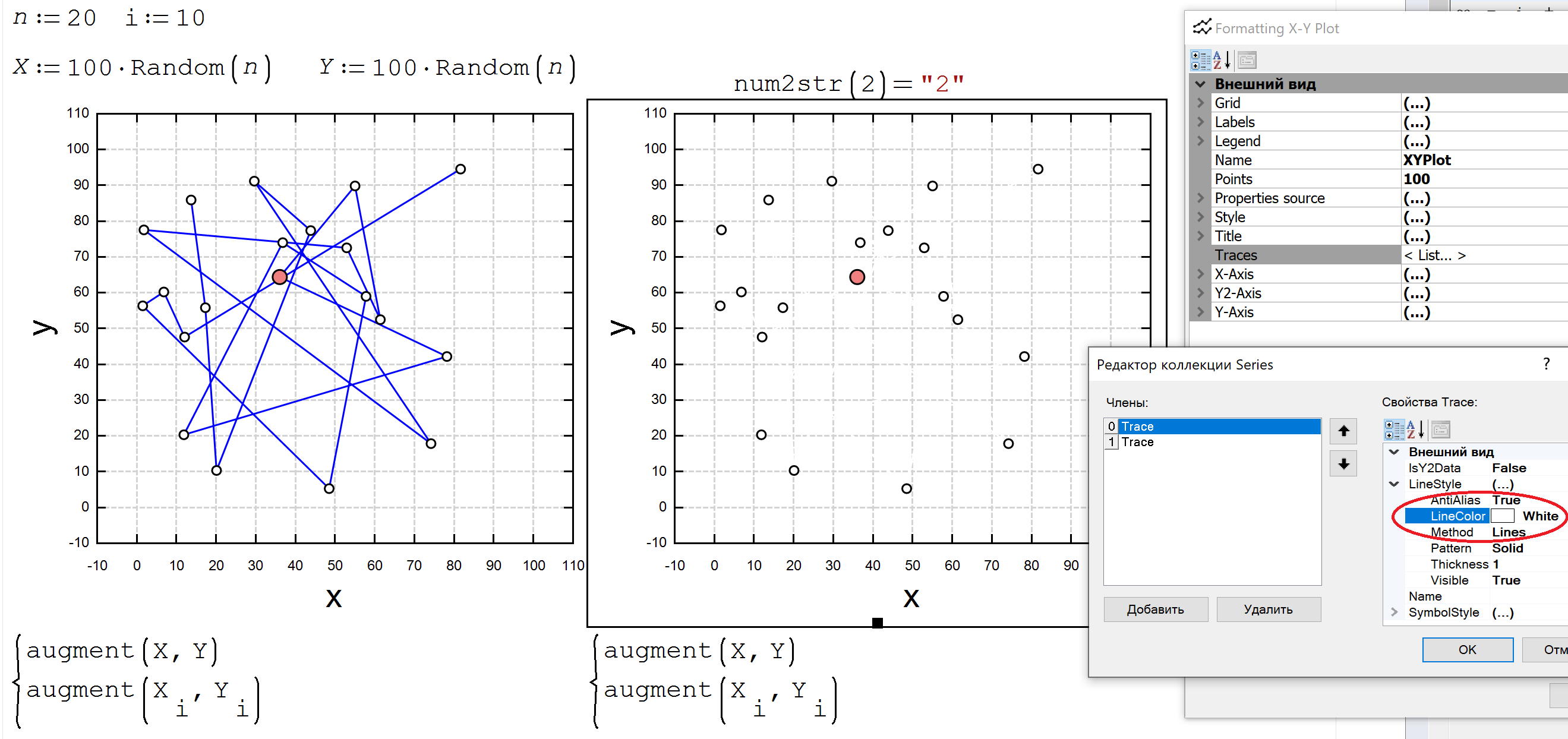

I can only remove the blue lines by making them white.
Is this my defect or the SMath defect?
Points.sm (8,34 КиБ) скачан 1460 раз(а).

You make your plot a segment of lines by using augment(X;Y).
Make every element individual if you want them as dots.
Is this my defect or the SMath defect ?
I use this feature commonly.

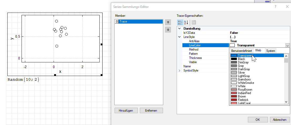

You can set the line color of any trace (input object) to transparent:

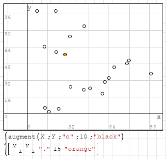

#5 Опубликовано: 26.10.2023 02:07:16
When it is possible, I would only use 2D plot.
X-Y plot is superior, but most times not needed.
