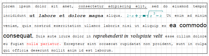

My background is electrical engineering and Smath has replaced excel as my go to software for doing engineering calculations and reports. Everyone else I know in the industry all use excel to do their calculations and then they copy the results in a word document to create reports. Obviously this is extremely inefficient as inevitable changes in inputs results in having to re-write reports.
The main features I need to produce professional looking reports though is rich text formatting and spell check. Because of this, I use the "Writer Region" plugin by Davide Carpi for all text and never use the standard "Text region."
I thought I'd throw it out there and see if most people would agree to integrate "Writer Region" to replace "Text region" or add all of the features of "Writer Region."

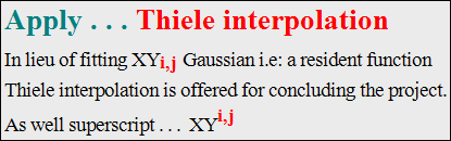

Smath Writer region can render same as Mathcad [8 Pro. 11]
Examine the Quadrics tutorial.
Cheers ... Jean.
Features like font options, alignment, line spacing imlpemented to text region.
You can even insert formulas in it. It will be a calculation if you want.
Yet there are also useful features not implemented to it.
Spell check is missing, also subscripting and superscripting.
You can't make lists inside or indent a paragraph, etc.
Some may need the features of Writer Region, some may not.
In past, I used it for some page design and font variations.
But improvements already made into text region are enough for me.
Nowadays, I don't even need Writer Region. I never use it.
I just keep it when I look into other users sheets.

#8 Опубликовано: 16.02.2023 09:24:28
Writer Region SS 6179 supports subscript/upper-script.
