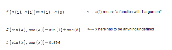

#2 Опубликовано: 07.07.2021 08:32:56
Yes it is possible, see the attached image

#3 Опубликовано: 07.07.2021 09:31:23
Paweł Wierzba
Paweł Wierzba
Thank you very much. Indeed, it works, even with functions with more arguments than one.
Sorry for asking a question about something that has already been implemented.

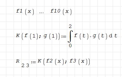

#5 Опубликовано: 07.07.2021 10:11:06
Paweł Wierzba
Paweł Wierzba

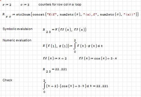

Thank you for the advice. Fortunately, standard way of defining functions is well known to me.
Unfortunately, I had to pass functions as arguments, rather than define them the "standard way".
I had several functions and some coefficients to be calculated, based on them.
Something like the example below.
If done the standard way, it would involve a LOT of writing.

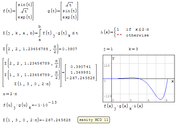

#6 Опубликовано: 07.07.2021 10:49:47
Attach the document for understanding that mystic doing.
#7 Опубликовано: 07.07.2021 13:23:49
Laurent Fournier
Laurent Fournier
9 сообщений из 66 понравились пользователям.
Beautiful!
I wonder why Jean is not so enthousiastic?
Great!
SMath has that awesome characteristic, so you can use that "standard way" for defining functions.
Good luck with your job!

Hi. You can try a for loop with something like this in the body

#12 Опубликовано: 07.07.2021 18:02:38

#14 Опубликовано: 07.07.2021 20:56:00
Interesting solution, promising to be very useful.
I wonder if it could be done with other functions.
It would really shorten a lot of thing if was possible.

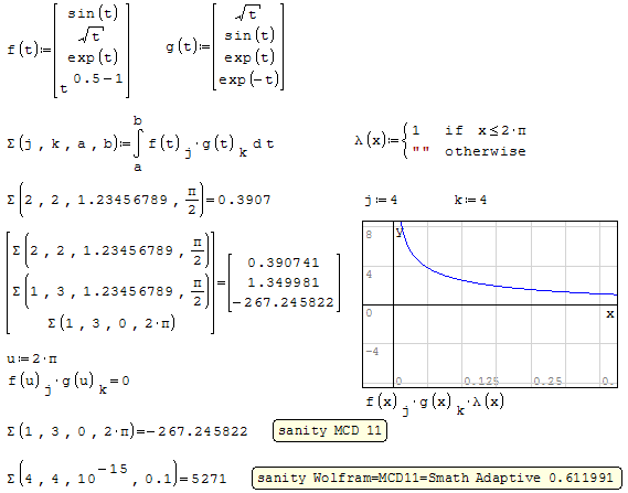

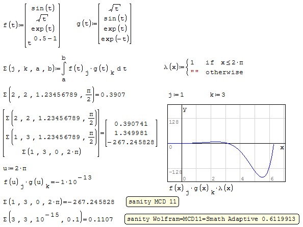

#16 Опубликовано: 08.07.2021 09:45:19
Thank you for help, especially the comment about potential problems
with the integrator and illustrative examples.
I posted the wrong image ... that's the right one.
Don't drop dead by how far simple integration can fly in the blue !

#18 Опубликовано: 08.07.2021 16:25:50

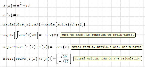

Looks like line() mysteriously solve the issue.
I have come across similar to this behavior before.
#19 Опубликовано: 08.07.2021 17:21:01
Hi. For help understanding what's happen: that behavior is similar to the SetDelayed in Wolfram Mathematica language: https://www.wolfram.com/language/elementary-introduction/2nd-ed/39-immediate-and-delayed-values.html
