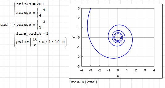

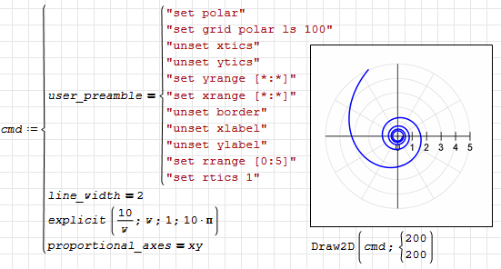

#3 Опубликовано: 26.07.2024 06:35:37
This is how it can be done using Maxima. Full flexibility is gained using direct gnuplot commands.
Draw2D3D-EN.sm (1017,89 КиБ) скачан 1720 раз(а).
SMath with Maxima.pdf (3,5 МиБ) скачан 4669 раз(а).
ioan92 26.07.2024 14:13:00, sergio 26.07.2024 14:58:00
