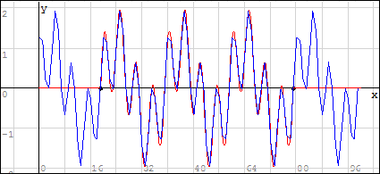

#4 Опубликовано: 05.11.2019 11:25:42
Hi. This function emulates the matlab filter function (https://uk.mathworks.com/help/matlab/ref/filter.html) Hope it's helps.
filter.sm (34,81 КиБ) скачан 1128 раз(а).
sergio 05.11.2019 12:49:00
#5 Опубликовано: 05.11.2019 18:15:55
... lot more smoothing in there.
filter.sm (49,5 КиБ) скачан 1114 раз(а).
Fourier Budapest39 Smoothing_2.sm (46,17 КиБ) скачан 1157 раз(а).
Fourier DCT-II [Data].sm (142,36 КиБ) скачан 915 раз(а).
