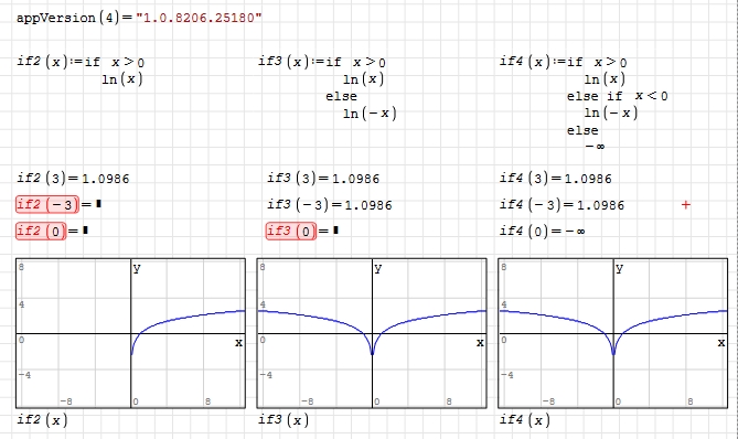

Hi Thilo. Not a bug, but a new feature. use "," or ";" for write more arguments.
From https://en.smath.com/forum/yaf_postst23148_Stable--SMath-Studio-1-0-8238--22-July-2022.aspx :
"if(..) function extended to support any number of arguments more or equal to 2;"
new_if.sm (8,51 КиБ) скачан 1548 раз(а).
new_if.pdf (36,57 КиБ) скачан 781 раз(а).
Shafiq ur Rehman 01.08.2022 15:02:00
Hi Alvaro,
thank you for your quick reply and for the information!
Thilo
Thilo
Thanks for explanation..
But SMATH help manual dated May 2010 should also be updated...
There are so many new features added and manual should include them.
Shafiq
Shafiq
