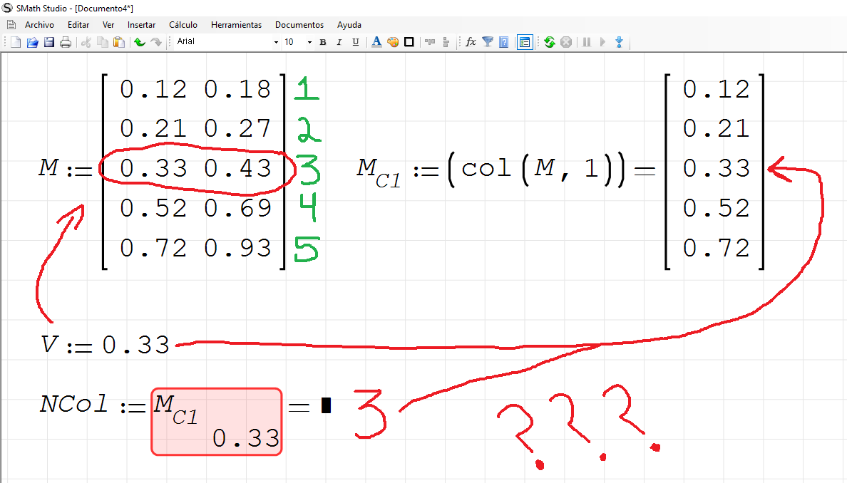

Do you know how to get the number of a row in an array?
ie I have a 5 * 2 array, I want to know what is the number of a particular row
¿Cómo se obtiene el número de una fila, de una matriz?
How do you get the number of a row, of a matrix?
I do not speak English, I hope you can understand me with the following image

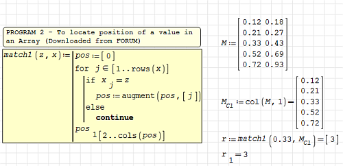

To find the indices of an array of values.
Cheers.....

WroteDo you know how to get the number of a row in an array?
These 4 are from a much larger compendium.
You will go a long route with them.
Utilities Matrix Truth Table [Locate row_col].sm (45,47 КиБ) скачан 1374 раз(а).
Utilities Matrix Locate Array1 Array2.sm (70,25 КиБ) скачан 1588 раз(а).
Utilities Matrix Truth Table [Locate row_col] COMPANION.sm (153,6 КиБ) скачан 1485 раз(а).
Utilities Matrix Treasury_1.sm (423,07 КиБ) скачан 1634 раз(а).

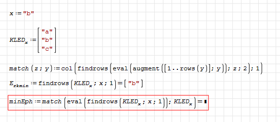

Erick Valentino 06.05.2021 07:32:00

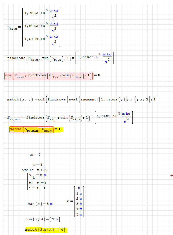

Wrotehey,
i have a some problem.
i hope someone can solve this problem too.
in the first exampe "match" its not working but in the second example it works. i dont know why

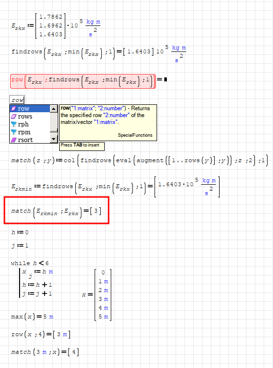

Hi Beyaz,
For first warning, row() expect a real pure number for second argument.
Your findrows() result is a number with N unit.
Due to your second problem;
I think commas in your subscripts makes the bug.
When they are deleted, your function match() works.
PS: Please provide your problematic file next time.
Rewriting your entire screenshot is cumbersome.
match.sm (10,75 КиБ) скачан 1545 раз(а).

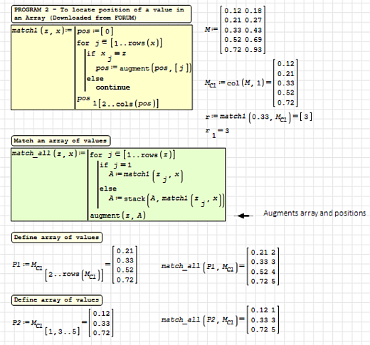

More utilities were designed and available.
These 4 will go a long route ... projects.
Created Studio, sanity checked Solver 30405.
Utilities Matrix Locate Array1 Array2.sm (70,46 КиБ) скачан 1555 раз(а).
Utilities Matrix FindIndex DUAL COMPANION Copy.sm (108,1 КиБ) скачан 1821 раз(а).
Utilities Matrix FindIndexKey COMPANION QUICK Copy.sm (89,52 КиБ) скачан 1665 раз(а).
Utilities Matrix FindIndexKey COMPANION QUICK.sm (89,51 КиБ) скачан 1613 раз(а).

thanks overlord
sorry, you are right, next time i will add the file.
i tried it but it doesnt work. this time i add the file.
vogt.sm (636,54 КиБ) скачан 1690 раз(а).

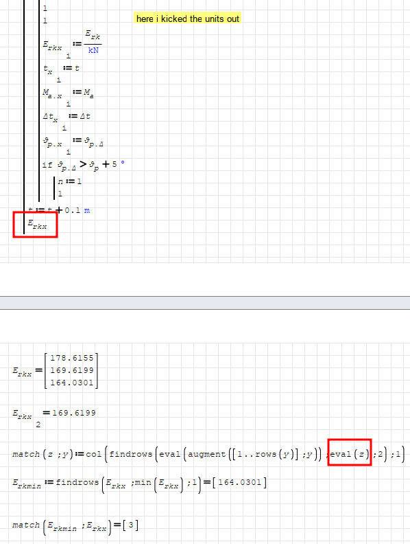

//I solved it like this

The result of findrows() is a matrix, even if there is only one match (exept for no matches, then the result is the number zero)
Converting it to a scalar, seems to help. The same could be applied to the overall result to remove the matrix.
Yet, there is a shorter way to get the index. This, however, won't work for multiple matches.
