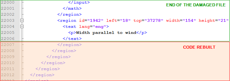

That's XML code, you have to begin something and to end it. You may have also if it is not expected that something should be nested inside it (this depends on the tag).
The code of your file was cut off during the last save, so something at the end of file is missing. You can see it because you should see as last tag, but this is missing.
What is needed is to close all the opened tags, then try to open it again.
