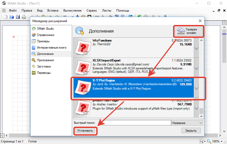

Does anyone have a suggestion on how to completely remove it so I don't get the message it is already installed or to make it 'visible' to SMath?
Install.
