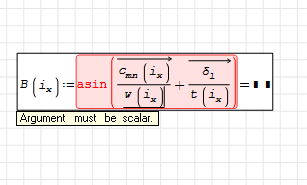

Thank you, it worked. But now im having a different problem, as shown below:
Wondering if it's truly unsolvable in Smath since I cant have scalars there bc I have to vectorize the functions
#4 Posted: 2/11/2026 12:18:58 PM
122 likes in 340 posts.
The external function "asin" should be evaluated element-wise.
Anna Ziobrowska 2/11/2026 2:56:38 PM

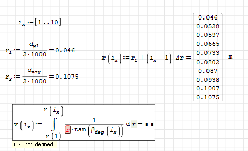

Thank you a lot, it worked. Got stuck again here:
#6 Posted: 2/11/2026 7:15:32 PM
Don't confuse subscripts (obtained, for example, with a.1) with array or matrix indices (obtained, for example, with a[1).
