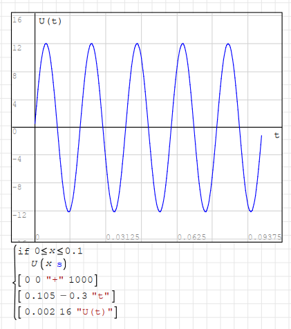

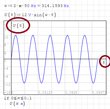

Now, is there a reasonably simple way to get t [s] and U [V] to the axes? Or at least some description. I really love SMath, and I didn't need the plots because I am mostly doing some mechanical engineering and machine design linear calculations. But as soon as I showed that software to my more electrical engineering-focused students, they came up with this question. I have been using Mathcad (v14 and 15) for a long time, and there is no problem doing this task very easily. I have been really surprised by how big a problem it is for SMath.

Historically, many components in a document have only one placeholder. This applies to plot components as well. Therefore, working with them is different. With only one placeholder, it's difficult to explain to the component what's expected of it.
This was originally done to simplify component creation. It was later retained for compatibility reasons.
Now, by default, the argument range is taken from the plot itself; it doesn't need to be specified explicitly.
In the plot above, we say to use the x-axis value with a specific unit as an argument so that the calculation inside the component does not return an error.
Using a vector (range variable) is a special case for X-Y Plot.
Mathcad will never be able to do this. This is one of the options.
#7 Posted: 3/18/2026 5:36:04 AM
591 likes in 1,369 posts.
Actually there is a simple way.
But you have to know something beforehand.
Because you are so used to it, you think mathcad-way.
You need to start thinking smath-way.

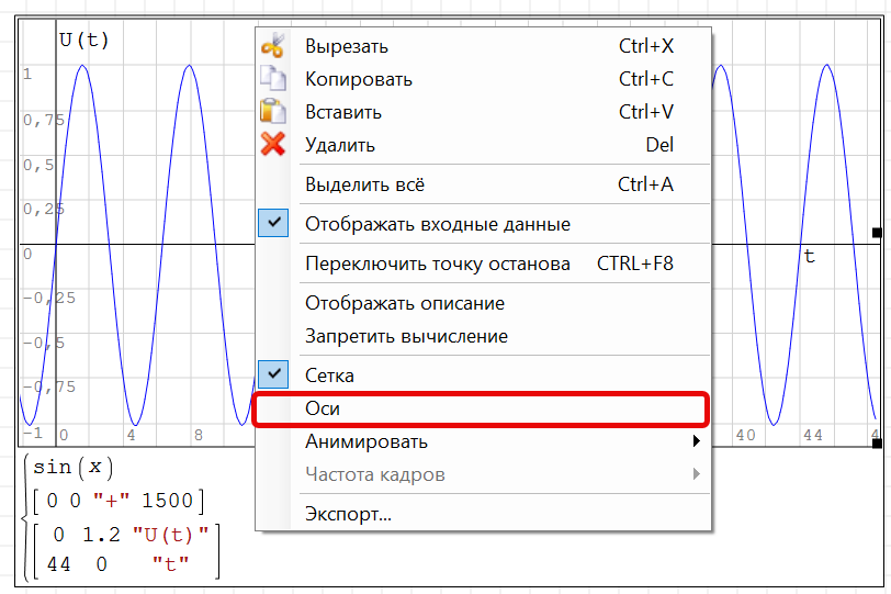

Thanks very much to all of you. I think now I see that working with units is no problem. My question was more cosmetical, presentational. Can the x and y at the axes be replaced? You know, those are the questions of my students.

I don't know how to do this for a regular 2D Plot. You could try disabling the axes and drawing what you need yourself.
#10 Posted: 3/19/2026 1:12:32 PM
Not easily, but original axes can be disabled via right-click.
And new origin rays and labels can be inserted.
However, this is not a perfect replacement.
You will need to manipulate each different plot.
Ok. One more silly question. How do I get the long curly brace under the plot to put the definitions there? I am clicking right-left, double-clicking... nothing.
Thank you
Edited 3/20/2026 12:40:35 PM
#12 Posted: 3/20/2026 1:06:48 PM
It is the sys() function. Matrices and system of values similar but not same.
Edited 3/20/2026 1:07:12 PM
