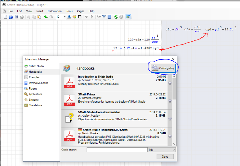

#4 Posted: 12/24/2015 5:02:21 PM
dio pants
dio pants
16 likes in 180 posts.
did you look at the handbook or links to learn SMath?
-> Tools-> Plugins -> Handbooks
You might want to download some of the online info too.
units- you can always define what you need in a worksheet if you need-
