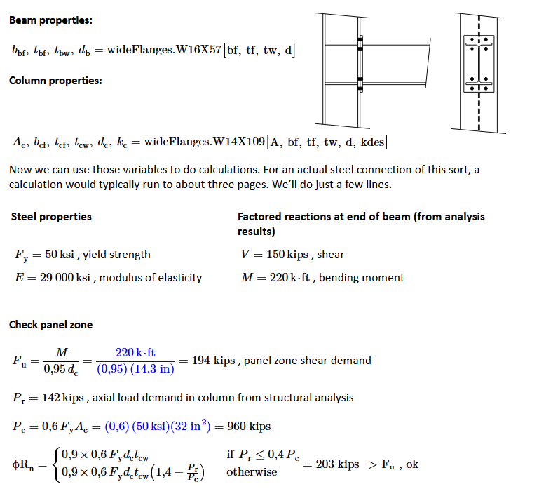

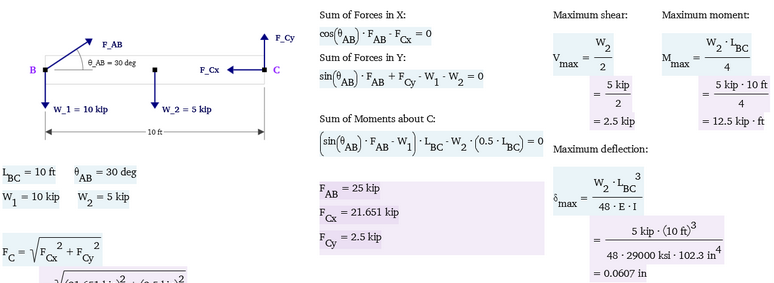

Meanwhile, there is other competition than just Mathcad.
Recently I came across the following two. They are on github, run in the browser and come with decent documentation. Yet their document format is notebook style (vertical sequence of cells)
https://blog.engineeringpaper.xyz/ (symbolic algebra and calculus, non-standard unit formatting, nice coolprops-integration)
https://hurmet.org/ (support of formula display with substituted values)
The commercial tool https://blockpad.net/de/ has already been discussed here, if I recall correctly.
I am not suggesting to switch to these systems (yet for some users it might be the reasonable), but to get inspirations as to what UI features might be useful.
