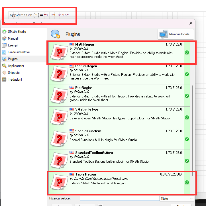

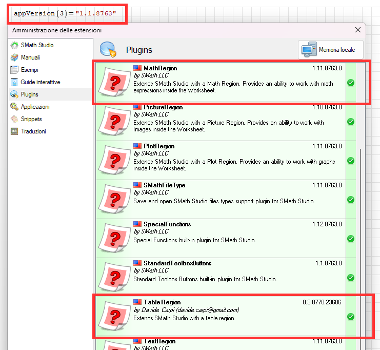

However seems you neither using the latest version too, since I see the error is somehow related to MathRegion 1.11.8763.0 that is part of SMathStudio 1.1.8763.
However in both these versions I cannot replicate the issue (at least with a fast check).
