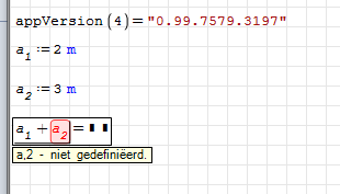

Dear all,
I use SMath for quite some time now, however I have a very basic question about an input issue that annoys me from time to time.
This is probably the most basic question ever asked on this forum ;-)
When I make a new calculation sheet with the following input, I always get the error "parameter a2 not defined":
a.1:=2m (subscripted variables are used here)
a.2:=3m
a.1+a.2=error
I get this error every time in this specific case, the input happens fast as I'm used to the input procedure.
The TAB-key has been used for confirmation, but for the unit input (m) as for the variable input (a.1 & a.2).
When I save the above file containing the error and reopen it, a.2 is depicted as a2 so without the subscript.
Which mechanism could be at the source of the above behaviour?
Thanks in advance for any feedback!

#12 Posted: 10/12/2020 3:31:13 PM
Jan Claeys
Jan Claeys
2 likes in 25 posts.
Dear all,
Thank you for the feedback!
@Andrey: thank you! I hope you can trace the concerned background process successfully. FYI: I use the most recent Windows incarnation (Windows 10 Pro; build 19041.508)
@Jean: it's a bug without any doubt (although not always repeatable), please see the screenshot below
Kind regards,
Jan

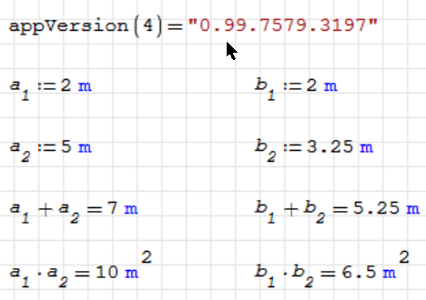

#14 Posted: 10/12/2020 11:37:05 PM
1,118 likes in 1,794 posts.
Hi. I can't reproduce the bug, but it could be interesting to know if, in the case you have the error, if you can see the tooltip about the variable value, as in the image. Isolated or when you write it into an expression. Obviously, autocalculation must to be on.
