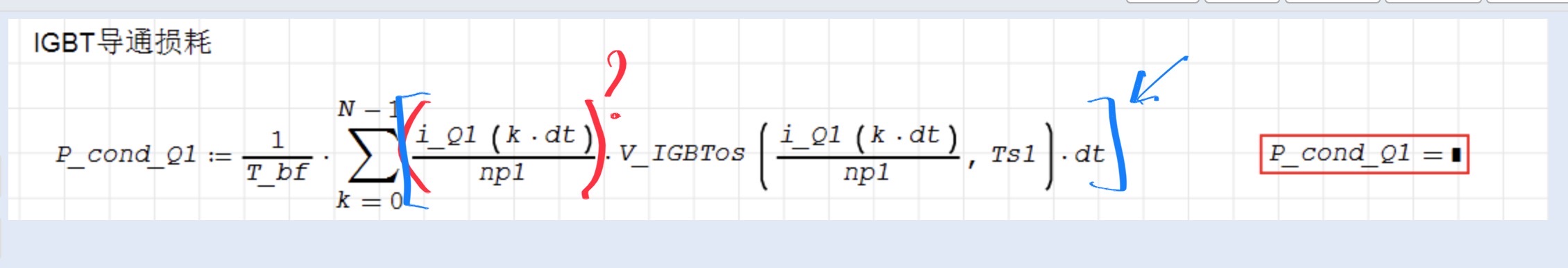

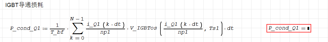

求和计算提示k没有定义
求和计算提示k没有定义 - 如图片所示,用求和计算以k为变量的函数,提示k没有定义,直接计算k是可以计算的 - Messages

There are a lot of terms involved, without a worksheet it's nearly impossible to understand what's the issue and how to solve it.

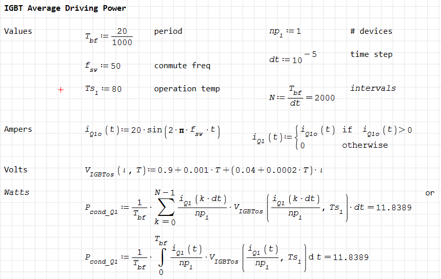

Hi. This is what the calculation of average driving power generally looks like, more or less.
IGBT Average Driving Power.sm (12.04 KiB) downloaded 293 time(s).
Regarding the error message, it might be because you're using `k` somewhere; the summation variable must be undefined. Try changing it to something else.

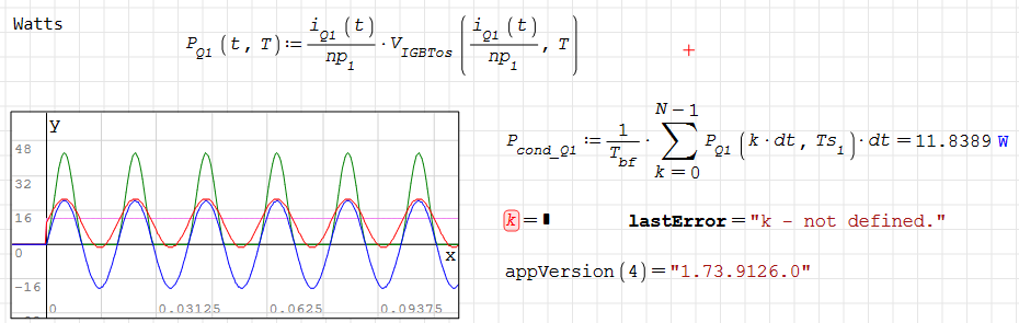

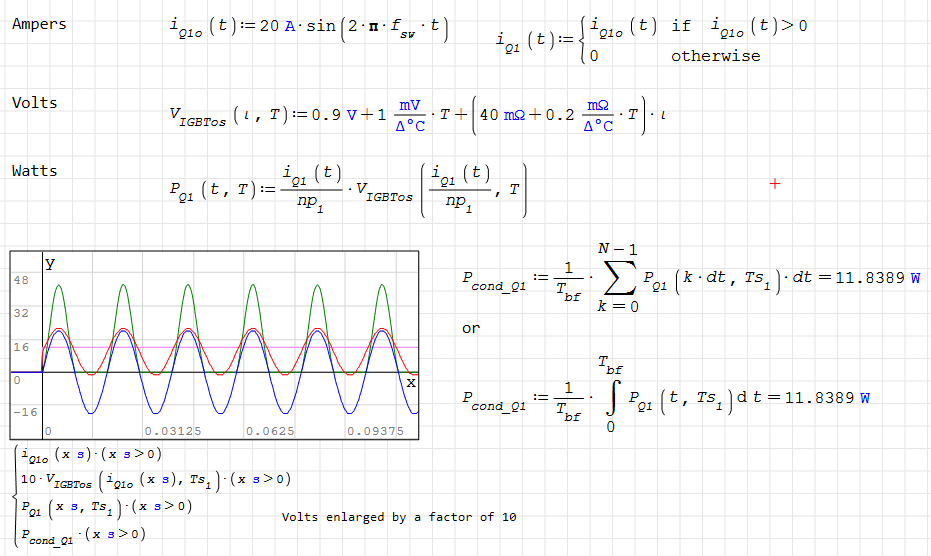

Hi. Units and plot added.
IGBT Average Driving Power.sm (15.89 KiB) downloaded 304 time(s).

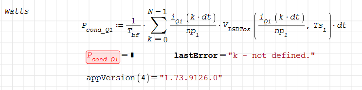

... This shouldn't be an issue anymore, I think it's more a operation order like Viacheslav pointed out.
The user wrote: "Summation calculation prompt: 'k' is undefined - As shown in the image, when using the summation to calculate a function with 'k' as the variable, it prompts that 'k' is undefined, even though 'k' can be calculated directly." so I assume he is using an older version of SMath. In the latest version, k does not "go outside" the summation, as the user seems to be indicating.

Hi. Also, this is what the error looks like in the current version in case of incorrect parentheses: with a rounded box filled with red, in a more retina-damaging style
IGBT Average Driving Power - bad parenthisation.sm (12.73 KiB) downloaded 302 time(s).
