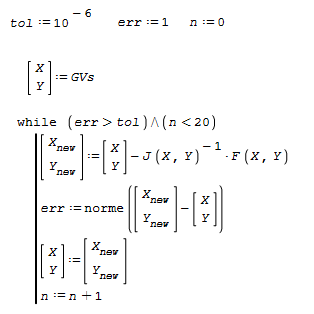

Instead of using for(3); you can use for(4):
for ▮, ▮, ▮
The four parameter 「for(4)」 gives you the ability to loop while checking a condition. Below is the description of for( {0}, {1}, {2}, {3} )
"For loop. The function of controlled iterations. The cycle repeats {3}, while {0} satisfies the condition {1} and after each passage necessarily satisfied {2}. Repeating expressions can be set to any number of expressions."
example:
for i:=1, i<10, i:=i+2
   k:=2*i
Where 'i' starts at 1 and until i is no longer less than 10, perform operation of k:=2*i. Apply operation i:=i+2 and check if less then 10...; LOOP!

Here's a "while" version
Newton-for-1-2-3-4_b.sm (18.98 KiB) downloaded 1617 time(s).

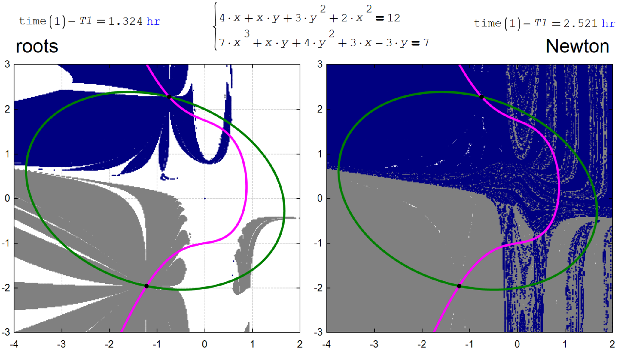

Valery Ochkov
Valery Ochkov
67 likes in 713 posts.
Roots vs Newton

#8 Posted: 2/11/2024 1:41:06 PM
Valery Ochkov
Valery Ochkov
Roots vs Newton
No interest vs the codes
https://www.mdpi.com/2227-7390/10/19/3413
