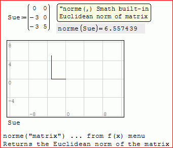

I want to plot a couple of simple scalar vectors. The question is like this: Sue walks 3 metres to the east, and then 5 metres to the north. What is Sue's displacement from her starting point?
How would I plot those two vectors in SMath? How would I then draw a diagonal line connecting the ends of those two vectors in order to calculate Sue's displacement from her starting point?
The length of a vector can be computated with the euclidean norm (wikipedia); do it for each vector you have, sum the results and you have the total displacement.
In a standard plot (type @ on the canvas) you can draw segments using matrices (x coordinates on the 1st column, y coordinates on the 2nd column); a path can be drawn with a single matrix or grouping single vectors with the sys() function (last element in the "Functions" panel on the right of your screen)

#11 Posted: 2/15/2016 12:00:57 PM
Hello, kernel.
So, I understand that you will kiss your girl friend if
you walk the right East/North distance while she walks a
lesser diagonal distance. What happens if both of you
end in the Pacific Ocean ?
More interesting: for spot testing of the camara objective
you will have to check the symmetry of the spot...
There is more about applying a correction matrix wrt the
mapping of the sensors.... Maybe a RemToDo in Smath.
More stuff in the attached.
jean
