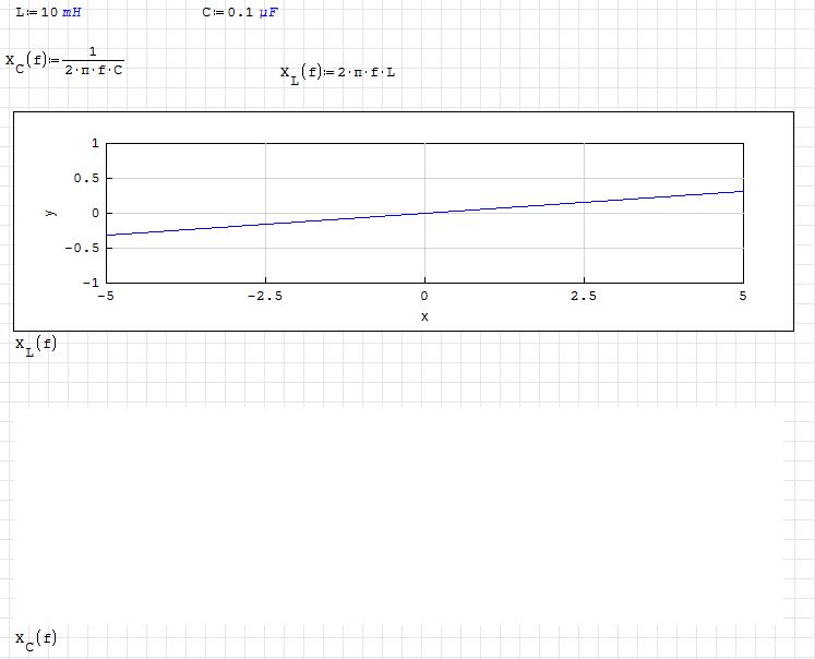

Hi Basile. A bug without the file could be hard to interpret.
But, unregarding math or bugs, you're trying to use negative frequencies. Are you sure about what could be represent that? Also, a zero frequency, what is it? Direct current?
Frequencies also are usually represented in a log scale.

Hi Basile. You discover a couple of nice and unwanted visual special effects in blue. I know near nothing about smath plugins, and can't help about them.

#7 Posted: 6/26/2016 7:51:00 AM
Seems the issue is related to negative infinity
#8 Posted: 6/26/2016 9:18:34 AM

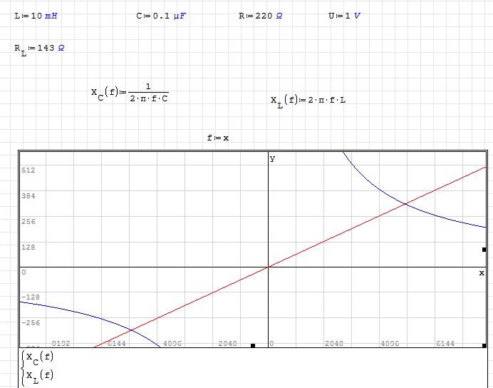

Basile,
What you did is no not correct: You copied the L
plot and put in it the C plot with the same L scales.
So, the C plot flies in the blue. Someting like this:
If you photograph a mouse and an elephant in the same
bed, you won't see both. If you adjust for elephant,
the mouse will be a dot pretty hard to isolate and
enlarge unless you have zillions of MP resolution ...

Jean,
Yes, it works with the Plot 2D.
The problem is with the X-Y plot. It disappears and freezes the instance of Smath!
As pointed by Davide a possible problem with minus infinity?
Basile
Basile

WroteThe problem is with the X-Y plot. It disappears and freezes the instance of Smath!
NO => Not as you think. X_Y is not an autoplot, it is a plot range.
If you plot sin(x) it falls in its default XY ranges OK. Otherwise
you have to range both directions. X_Y does not supports few things:
1. It does not plot x. It does not understand that 'x' is implicit
of 'x' = "1*x" neither implicit of 'x' = 'x+0'
2. It supports some common Engineering ranges 1*e ±3 [per say]
but will crash Smath instance if you want to range 1*e ± -15
X_Y is lovely in many projects but not in others.

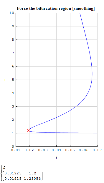

By increasing the limit values of the function the graph does not
pass through a pivotal point

WroteBy increasing the limit values of the function
That's right but not a bug. Just that above the Y magnitude 45,
the canvas misses some points in the critial region.
More: does not fill the circle, plots x instead of +
X_Y Plot wisely.sm (11.2 KiB) downloaded 1339 time(s).
