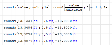

round(value,n) rounds a value to the n-th decimal digit, what you are looking for instead is a function that rounds to a multiple of a generic number, and it is really easy to have it:
note that this works indipendently from your units system (just place 'ft in the rightmost placeholder if you are using imperial units with base SI system and vice-versa)
