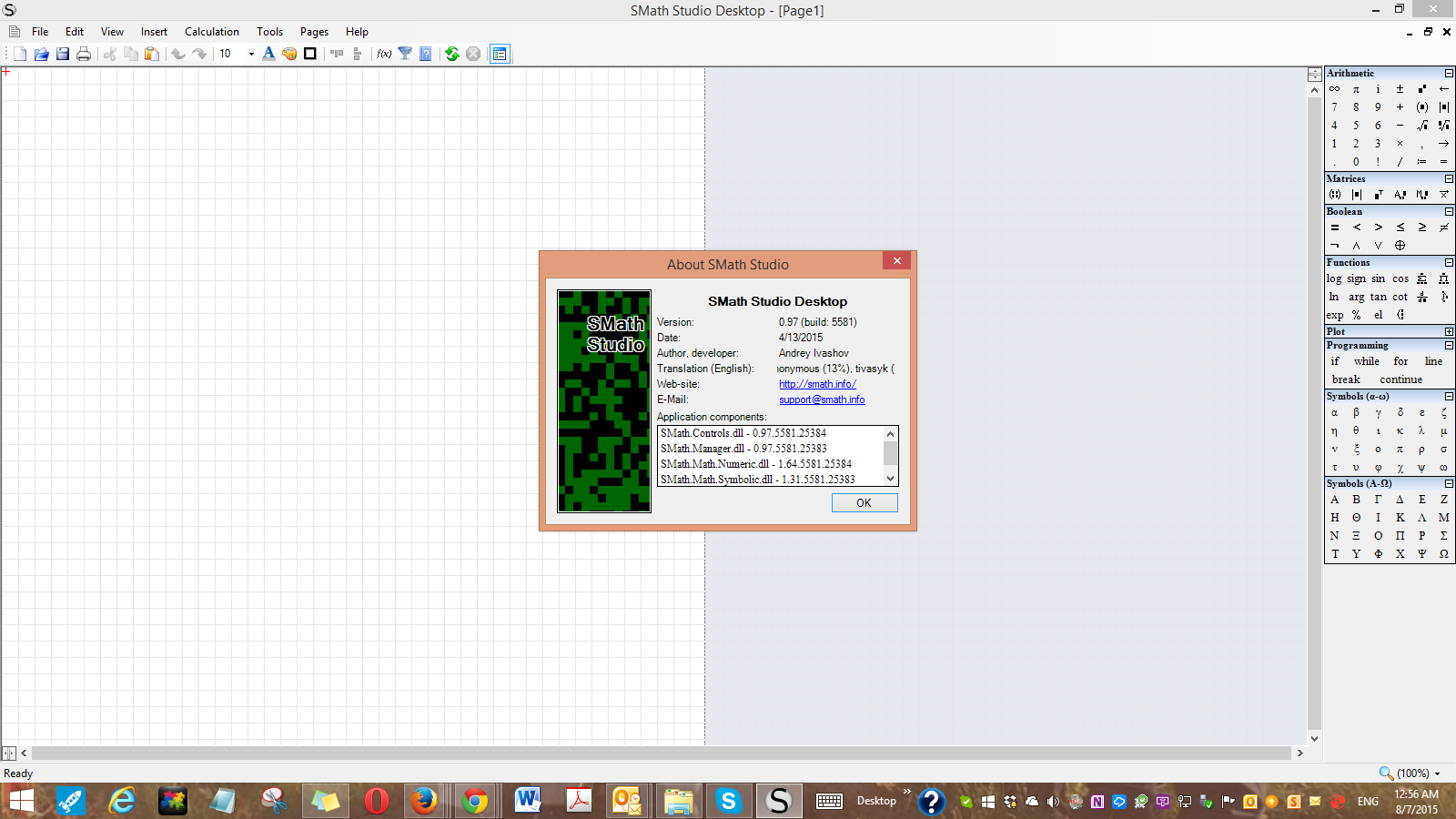

I attach the Insert menu and the Help>About.
Can I try something to help solve the problem?

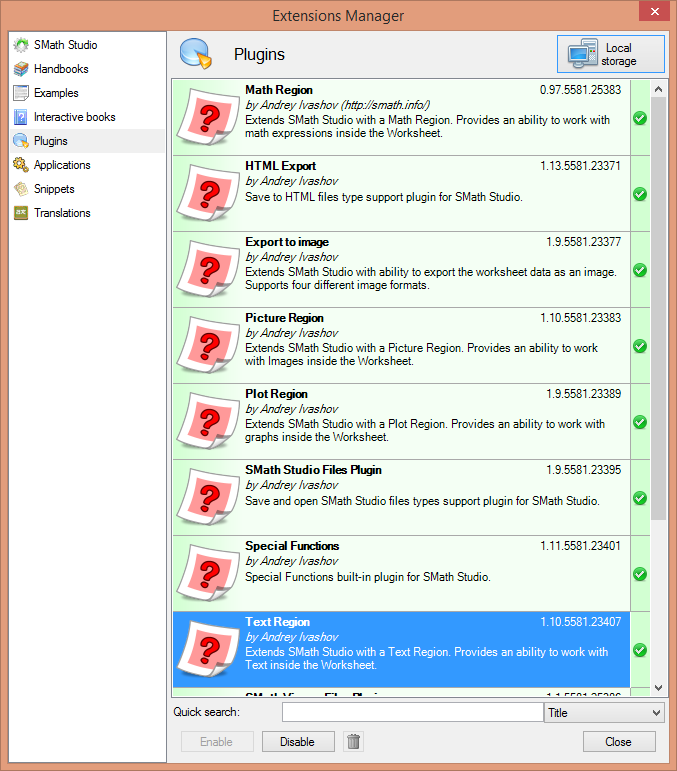

#5 Posted: 8/7/2015 6:33:44 AM
1,443 likes in 2,936 posts.
Looking at your screenshot seems you have just the built-in plug-ins (that is ok in a clean install). Have you tried to download a plugin from the gallery? (f.e. the "Checkbox Region" in the screenshot or any other Region plugin)

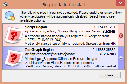

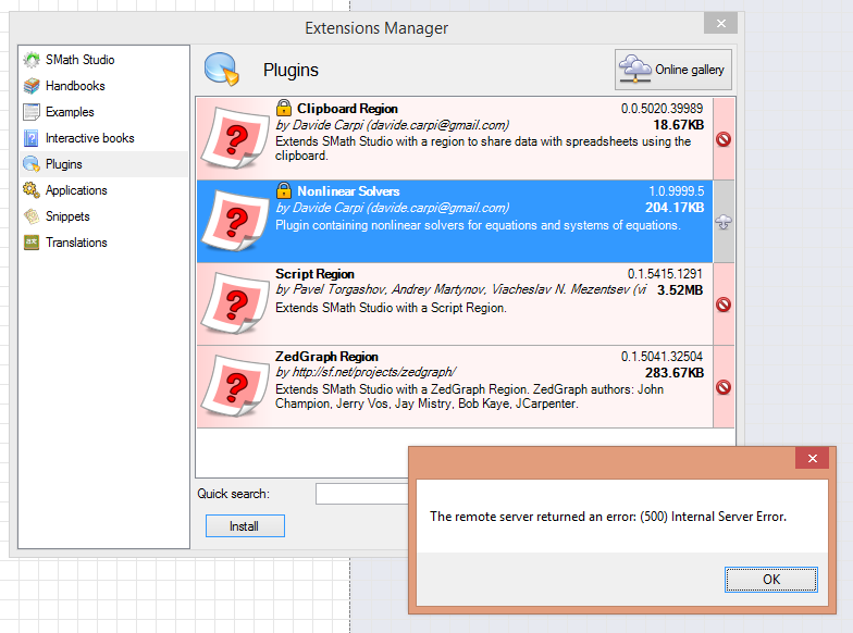

During installation the:
Clipboard Region
and
Nonlinear solver give an error
While the
Script Region
and
ZedGraph
fail
Thank you,
Basile
#7 Posted: 8/8/2015 6:32:20 AM
The "Installation failed" error of Script Region/ZedGraph is because these plugins are made for an older version of SMath Studio. If you are interested on them, you may ask the author (uni) to update the plugins.
The server error on Nonlinear Solvers may be related to a wrong password (here the correct one)

I was able to load the "NonlinearSolvers" by providing the correct password. Thank you.

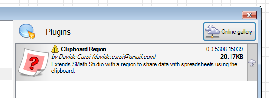

Then open again SMath and check the gallery, you should see the Clipboard Region version 0.0.5308.15039. If you still have the older version let us know.

"...you should see the Clipboard Region version 0.0.5308.15039."
When I am opening SMath I get another version. (SMath07)

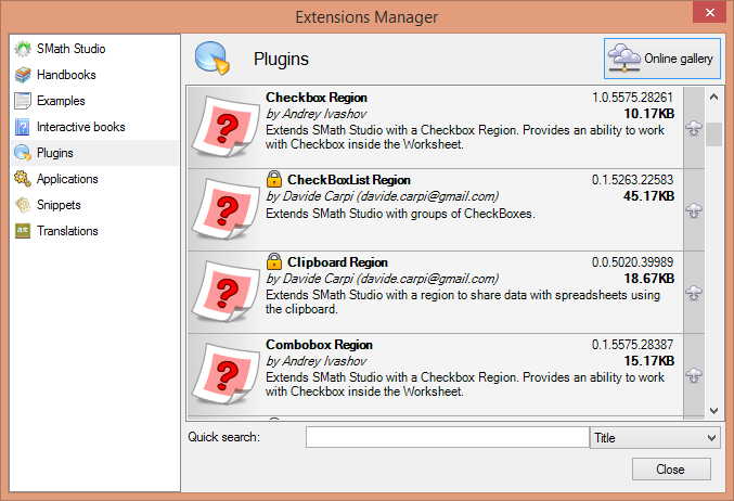

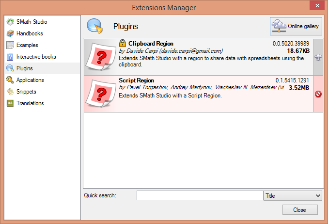

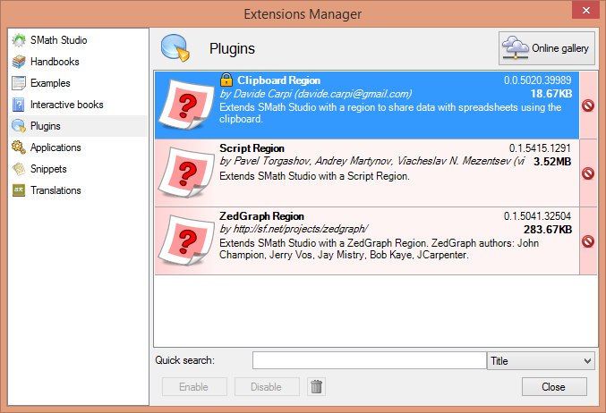

When I start SMath, I get (SMath06)

Basile, ZedGraph and Script - these plugins haven't been updated properly. Some of my plugins are unstable (maple 5 probably). All other my plugins was updated yesterday. If you see another version this means that the author working on it.

The Clipboard Region still (after deleting the plugin from its folder)appears as an older version 0.0.5020.39989 instead of the newer version in the Extensions Manager>Online Gallery.
Attempt to install results in Installation failure.
Please, see icon in previous message above.

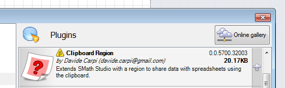

I've recompiled and uploaded the plugin for the latest beta build (SS 0.97.5581), please check if this is available and works for you (ClipboardRegion version 0.0.5700.*)

#14 Posted: 8/11/2015 10:50:22 AM
Basile
Basile
8 likes in 172 posts.
I deleted the existing plugin according to the instructions provided in previous email above.
I restarted SMath.
I do not get the newest version.
Any suggestion? Uninstall and install. I would be happy to help.

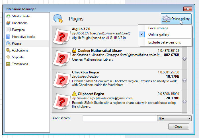

#15 Posted: 8/12/2015 10:09:17 AM
Basile
Basile
Ioan,
I used Geek to uninstall it.
I installed. Same problem
I used Geek to uninstall again.
I install a previous version of SMath. Same problem.
How it is possible to see a version that I assume is not in the server because it has been updated?
Basile

The server contains all the plugins published. Each plugin has a target version (because the changes in the SMath core may add/remove features for the external plugins) and you should be able to view and download just the most recent plugin for your version of SMath Studio; therefore if you have the latest Nightly Build you should see the latest Clipboard Region and not the previous, while you should see an older version if you are using (f.e.) the latest stable plugin.
In your first screenshot pair (SS 0.97.5581) the most recent plugin (0.0.5700) is not displayed, I think just Andrey can solve this...
