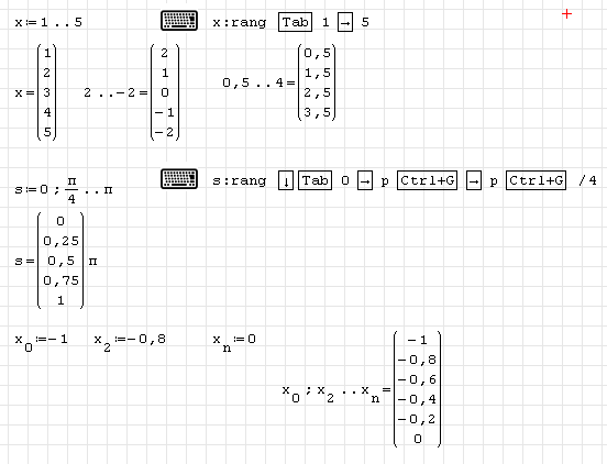

#3 Posted: 11/13/2013 11:26:36 PM
First, thank you.
Second, quick question, in the 'for' statement shown above (for i from 1 to n+1) how do you get the two periods (the "to" part of it)? What keys are pressed?

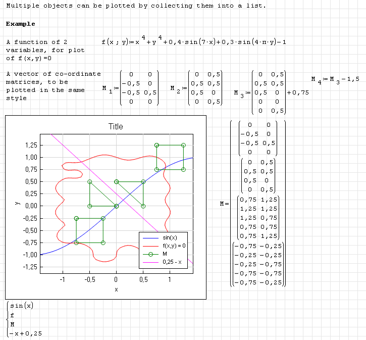

#6 Posted: 3/7/2014 4:01:56 AM
What exactly is your issue? As I could see, you just did not change the scale for X-Y plot and therefore did not see your data plotted.
