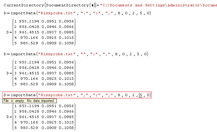

#2 Posted: 3/27/2015 10:49:41 AM
Same result as your if I use comma as decimal separator and semicolon as argument separator
the result below is if I use period as decimal separator and comma as argument separator
![2015-03-27 14_47_28-SMath Studio Desktop - [importdatabug.sm_].png](/en-US/files/Download/MNQZyv/2015-03-27-14_47_28-SMath-Studio-Desktop---[importdatabug.sm_].png)
