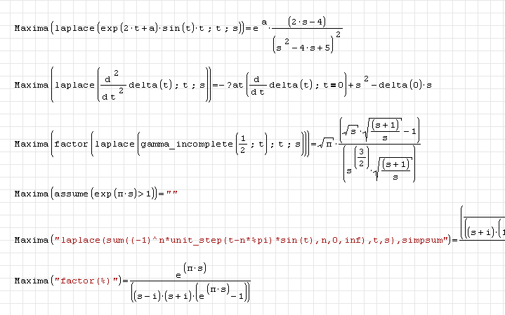

#3 Posted: 10/10/2013 3:17:39 PM
1,359 likes in 2,273 posts.
You might try the Maxima plugin. Maxima is free and open source. I tried to reproduce some of the handbook examples.
