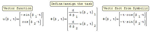

You can use the function vectorize(), a loop, or ranged indices... choose the one that fit your needs
diff.sm (7.47 KiB) downloaded 1350 time(s).

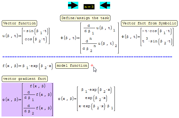

This is NOT unit vector. My understanding is that you want
a general procedure to differentiate a function vector.
This simple demo procedure is the core algorithm in Smath fitting functions
1. Genfit ,,,, 2. linfiCheby

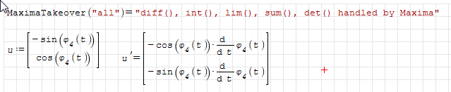

Here is another one. Maxima has generic vector-/matrix handling
diffm.sm (3.68 KiB) downloaded 1310 time(s).
