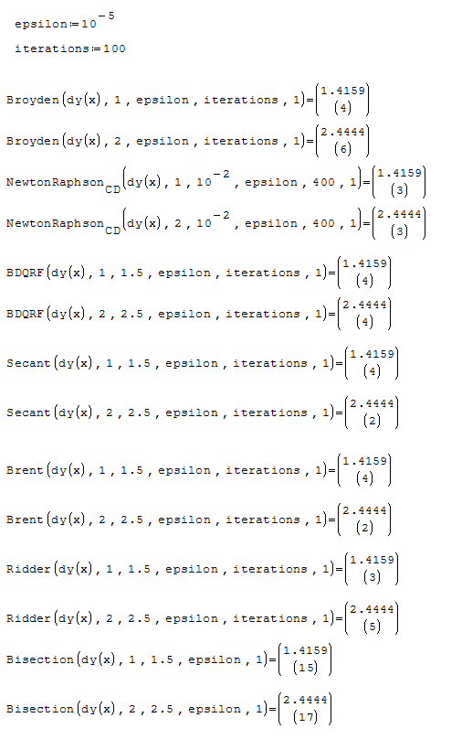

Here is another example I wanted to solve for a long time in SMath. Actually, you can not have a real numerical derivatives in SMath and I also mentioned that few times. If the expression is a bit more complex, there is quite a chance of getting into trouble with derivatives. Moreover, you can not find numerical derivatives of a spline function in SMath. Here is an example where I used Gradient.CD() from the BETANonlinearSolvers (see this thread - this plugin includes many other "derivative free" numerical procedures). I do not know any other more elegant way to solve these kind of problems in SMath. Although it was mentioned here BETANonlinearSolvers among many other things, I just put this example here because I wanted to get it into attention once more.

I do not know, sorry. It works for me. Actually, my point was that the differentiation in SMath is problematic - actually there is no pure numerical differentiation at all (there is a numerical integration procedure but SMath's symbolic engine does not have symbolical integration yet). If you want to solve a nonlinear equation, just use the mentioned plugin (SMath's solve() and roots() might give us a hedeack sometimes ). There are many functions for this problem. Here is the previous example with the functions for the nonlinear equation solving from the mentioned plugin.

My problem is due to optimization type. For me, your file only works with "optimization none" except for Brent method, which doesn't works with none optimization method.
