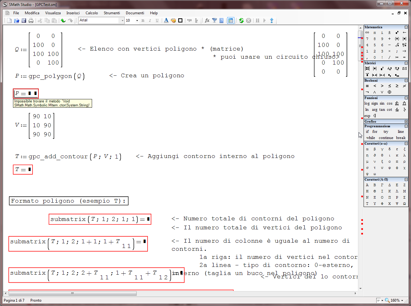

#7 Posted: 10/28/2019 1:14:05 PM
127 likes in 342 posts.
The plugin GPC Wrapper seems it does not work with build 7219
(Could not find the "Void" method)
#8 Posted: 10/29/2019 1:26:41 PM
1,443 likes in 2,936 posts.
Thank you Sergio, I will look at it as soon as I can.

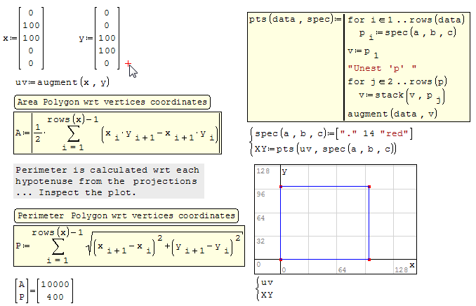

#9 Posted: 10/29/2019 4:10:38 PM
What about closing the polygon ?
#10 Posted: 10/29/2019 4:37:29 PM
Jean,
the plugin provided for the double chance (as can be seen in the upper left of my screenshot) but at the moment with the updated smath version (7219), does not work.
#11 Posted: 11/16/2019 1:41:18 PM
Fixed for latest available Nightly Build (0.99.7250)
frapuano 11/17/2019 8:57:00 AM, sergio 11/16/2019 2:22:00 PM
