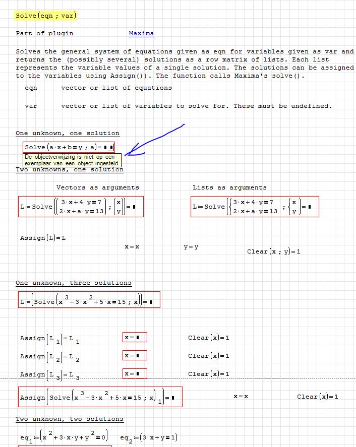

#4 Posted: 8/23/2017 11:07:04 AM
#5 Posted: 8/23/2017 6:32:45 PM
Many Thanks for the help sofar. I downloaded v14 + maxima en try to use the solve function, but I got the message as displayed in the enclosed file:
Translation of Dutch message: The reference of the object is not adjusted to an item of the object
What can be the problem ?
Another question: the solve option under the Calculation tab is grayed out. It seems I can not use this solve option. What can be the point ??
regards,
Sjoerd
regards,
Sjoerd

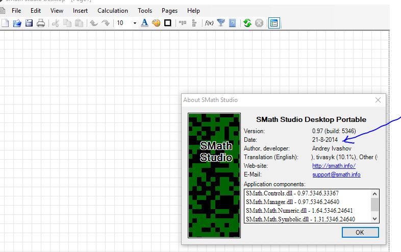

#7 Posted: 8/24/2017 4:53:03 PM
I use version 14 as is visible in :
I use windows 10 . Can that be the problem.

#8 Posted: 8/24/2017 5:58:24 PM
I can only handle problems with SMath 0.98.6398 and newer (nightly builds), at least if related to the Maxima plugin.
With this new version the configuration of the Maxima plugin is easy (I streamlined the settings dialog and fixed several bugs).
Just follow the instructions on http://en.smath.info/forum/yaf_postst2078_Maxima-Plugin.aspx. There have been reports of successful installation under Win10, however, I rund Win7 and thus rely on third party reports. Let me know if there are problems and also if everything goes well.

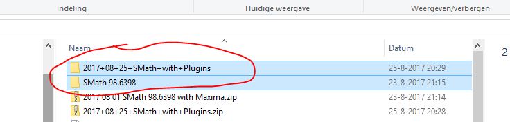

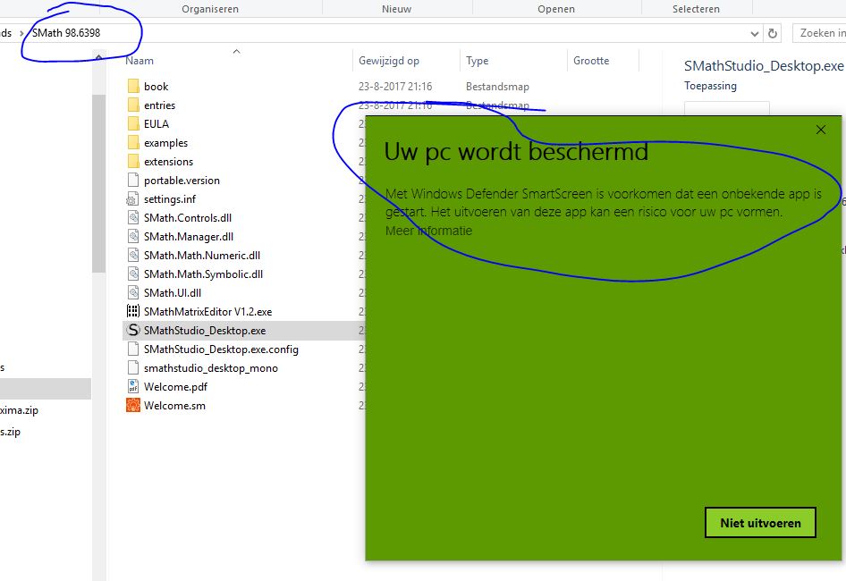

#13 Posted: 8/25/2017 5:05:10 PM
The only change I did to the executable was to set the 32 bit flag which is required for the Mathcad user library interface to work (Steamtables and Special math functions libs, userefi plugin). If you don't need this, then replace the executable in the portable distribution by the one in the LINUX version (yes, even if you are under win).
If that doesn't work you can still try the installation procedure described in http://en.smath.info/forum/yaf_postst2078_Maxima-Plugin.aspx. This exclusively uses original installers.
