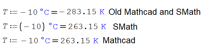

It is important to note that temperature is a variable unit in SMath and not a function as it is in Mathcad.
Regardless, the first line is converting 10°C --> 283.15K; and then applying the unary operator of minus (-) to the value; thus: -283.15K; Make sure you apply the unit °C to -10 and not just 10; use the space bar to group your operations correctly.
When in doubt: use parenthesis for grouping your operations.
May this be of Good Help,
- SK Kenny Lemens, P.E. ᵂᴵ

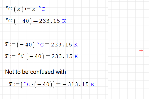

This is not a bug, this is how SMath works.
You have to use delta temperatures for that kind of calculations.
Unfortunately there is no easier way.
If you really need to calculate without delta temperatures,
You can use a custom equation/function like this.
