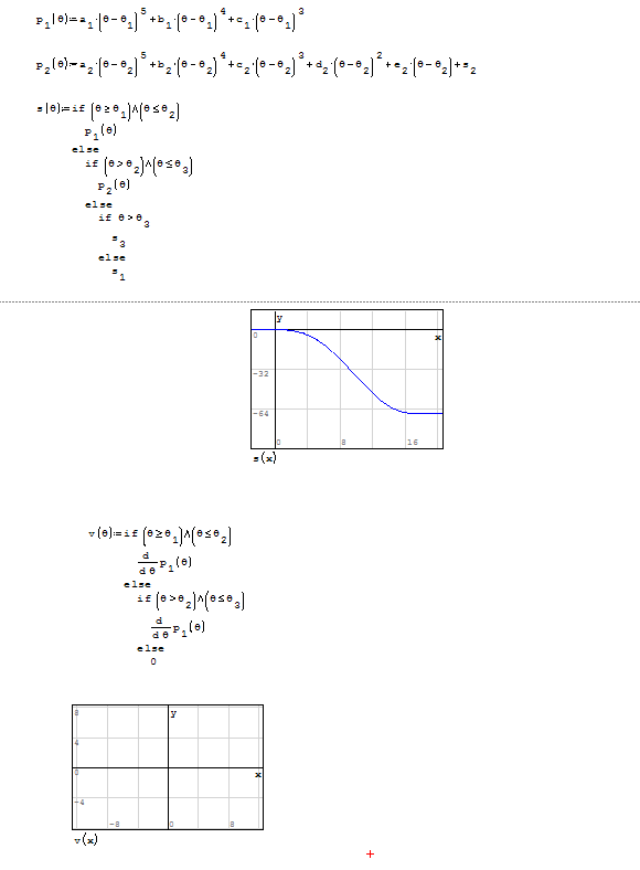

Hi to all, I create a composed function, but I don't understand what is wrong.
Please help

I attach the file to clarify the problem
2spline.sm (26.73 KiB) downloaded 1309 time(s).

When defining a1, b1, c1.. etc, you define them as rows of a matrix (notice how they are still in parenthesis), and they remain a single entry matrix. This causes an error later on since you can't take a derivative of a matrix.
Instead of extracting the row, extract the element by using the "el" function, or write the matrix name followed by "[" and the row number.
eg. a.1 : M[1

The cases() function helps a lot in writing piecewise continuous functions in a readable way.
2spline_Kr.sm (23.73 KiB) downloaded 1346 time(s).

Hi, Ernesto and Martin.
Thank you for your help.
I'm new to the use of smath studio. I understand my mistake....It's a mathematical error!
Now I have istalled the Function extension.
Bye
