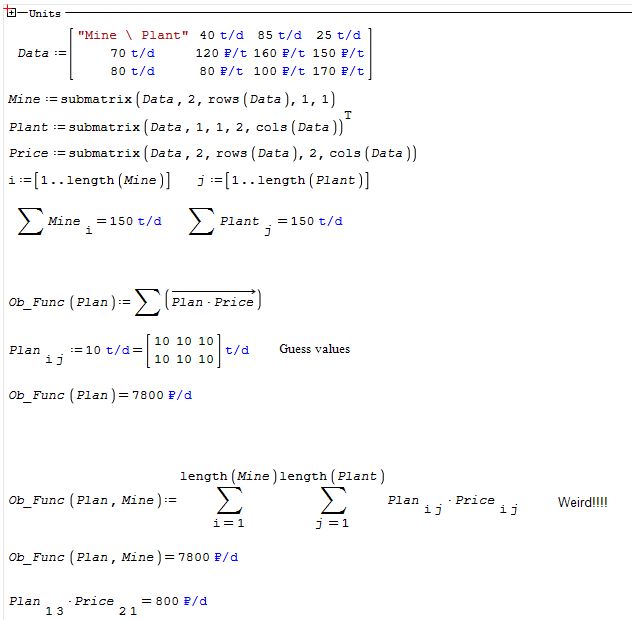

See please the picture and the attach
Transport-b.sm (13.63 KiB) downloaded 1573 time(s).

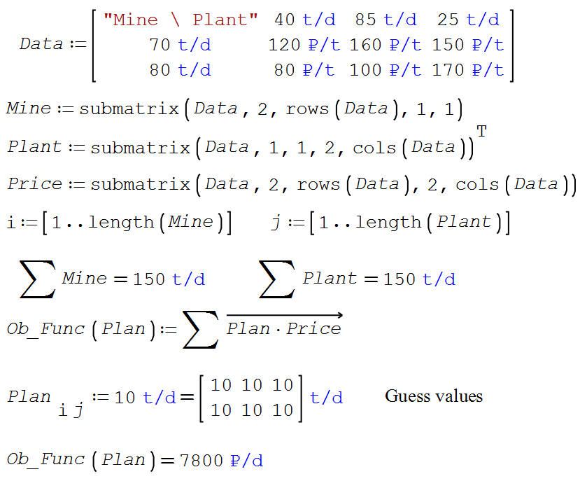

Like so?
Transport-c.sm (14.58 KiB) downloaded 1578 time(s).

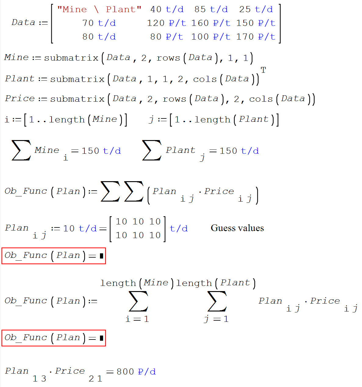

Transport-d.sm (11.2 KiB) downloaded 1569 time(s).
