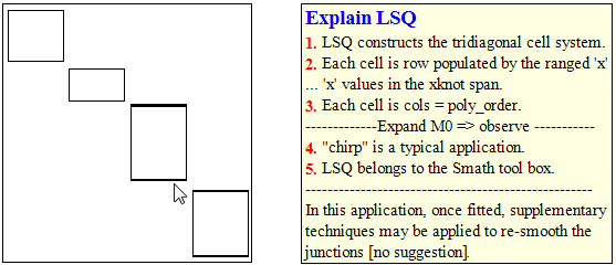

The chirp challenge was proposed by Mathsoft [DAEP, 2003].
Conventional smoothers [most known ones] fail miserably.
3 methods do recover the signal:
1. Robert Advanced LSQ [a supplementary step to this basic one]
2. Spline_2xV6 [independent freeware software]
3. linfitCheby. Smath delights crunching "linfitCheby".
Polynomial fit CELL Copy.sm (230.48 KiB) downloaded 1313 time(s).
