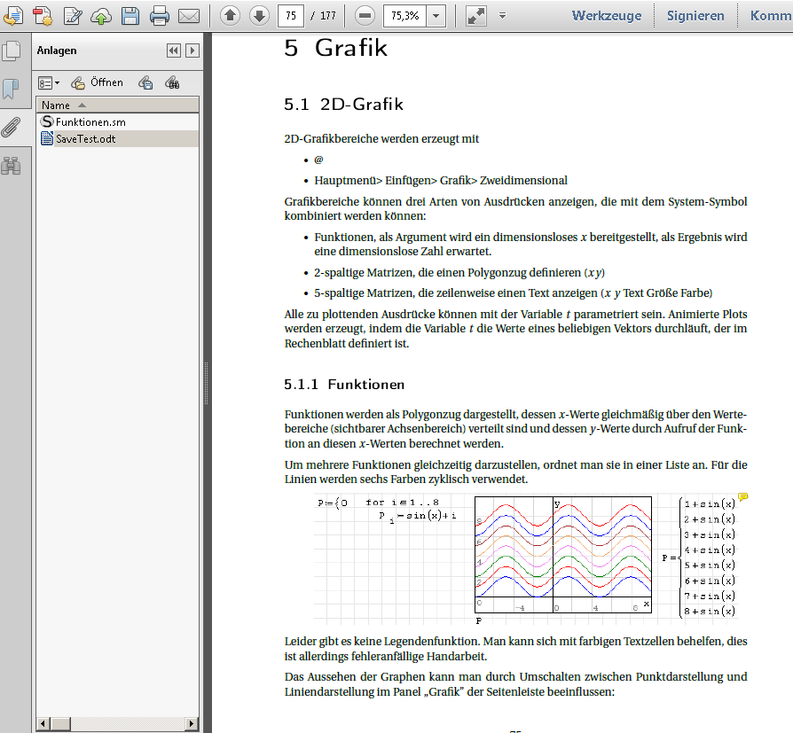

Attaching files to pdfs from within latex seems to work. I updated the handbook in the wiki (link in signature) which now contains two attachments: 1 sm on page 75 and 1 odt on page 46.
My experience in testing the file with different viewers (double clicking the links should open the file in the appropriate application):
texworks: completely unaware of attachments
Acrobat Reader:
sm file: "no associated application"
odt file: ok (open in Libre Office)
Foxit Reader: complains about illegal characters in the filenames (they have a " attached at the end)
PDF exchange viewer: same as Acrobat reader.
Acrobat and PDF exchange viewer can save the sm file to disk, from where they can be launched from file manager. Thus the file association is there. However, there seem to be different levels of tightness in these associations. LibreOffice and OpenOffice find their way to the standard software definition page in the systems control application, while SMath does not.
Any idea how to fix this is welcome.

By default I open worksheets with an old version of smath and your embedded .sm was opened correctly with xchange and acrobat readers (the.odt as well with msword),
however I wanted to see what happened when opening attachments with the current version of SMath and so I got the same problem as you
I changed back the association to the old SMath and the attached file opens well again.
It looks like something related to the current SMath version 0.95. At least with 0.89 attached .sm are opened right.

pdf attachments work for me with the portable Smath version (pity it doesn't support plugins)
I unistalled the old version and removed all file associations, and tried to open the pdf attachments with the newest one unsuccesfully,
so I would say it is a problem with how the newer smath versions (for old versions seems to work) deals with the installation process and file associations in the registry.
