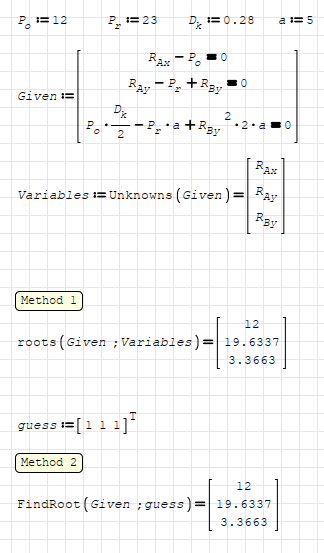

I would like to solve a system of linear equations in Smath Solver as in Mathcad. Is it possible?

I'm already browsing Solve Grand TREASURY. I am sending missing data in the file.
Reakcje.sm (3.74 KiB) downloaded 1342 time(s).

Sorry, I don't know how to put the matrix at the end.
Reakcje.sm (7.59 KiB) downloaded 1316 time(s).
