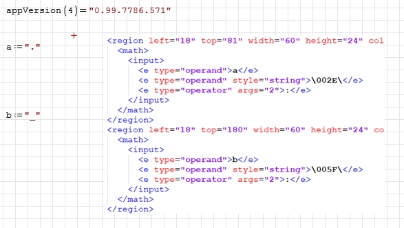

Hi Davide. The issue persists for release "0.99.7786.571":
test.sm (2.38 KiB) downloaded 1488 time(s).

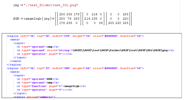

It works for me even if dots, slashes and underscores are encoded
Hi Davide. Yes. you're right, it works with encoded strings now, I see the strings, and no check if can read files with that.
So, standard ASCII characters lower than 128 will be encoded as Unicode? That can introduce a lot of issues for low level manipulation to the user.

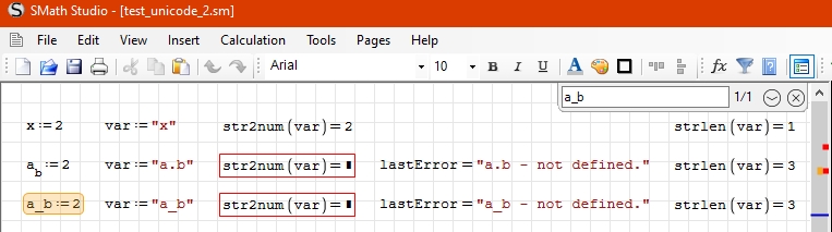

test_unicode_2.sm (5.82 KiB) downloaded 1544 time(s).
Also, the string "a_b" doesn't appear in the search box, but if you search for x, x and "x" appear.
Also, suppose that I want to find an sm file where it's defined the function "my_function_1": I need to search now the string "my\005F\function\005F\1" inside the files?
Thank you! Fixed.
