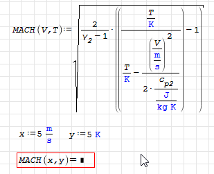

I've never tried to establish a multi-function variable in SMath until now.
I thought the function illustrated below should run fine.
Can anyone point out where I went wrong?
Also, can anyone help me with a strategy of dealing with input units and subscripts. SMath does not appear to like it where i try to type units into my input, whereas this is necessary to balance the equations in the function. The subscripts in one force the remaining variables to be entered as remaining subscripts.
It appears to me that I should use some functionality of the menus to create the list of variables, because manually typical them is a real problem.
I am trying to transpose all of my previous research from MathCAD to SMath, and expecting a super-clean result. Any help will be appreciated.

Jean,
Thanks for the assistance. Please find attached the file I started that contains the error.
HPC Short Revise AR makeup.sm (96.22 KiB) downloaded 1220 time(s).
The only thing I see is that your c is unitless, while mine are included. Is that the problem?
I just tried to render the units out of the function, but to no avail.

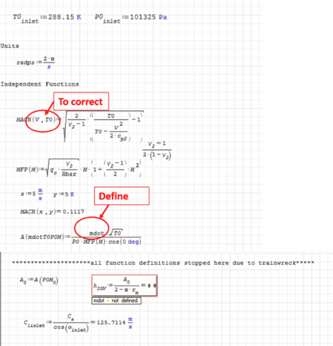

#8 Posted: 12/26/2017 2:04:55 PM
WroteI just tried to render the units out of the function, but to no avail.
Only POM is not defined [red]
HPC Short Revise AR makeup.sm (98.33 KiB) downloaded 1181 time(s).

#11 Posted: 12/26/2017 3:57:43 PM
John:
Well, in this case, the main problem was that the user's function was incorrectly defined.
You just have to follow the rules that are indicated in Smath Studio in the creation of
a function by the user: https://en.smath.info/wiki/User%20functions.ashx.
Regards.
Carlos
Regards.
Carlos

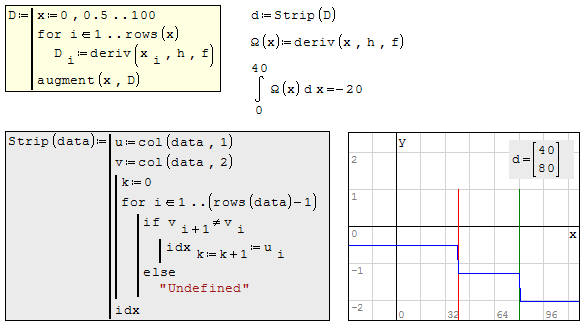

#12 Posted: 12/26/2017 10:15:39 PM
Besides exemplified rules, more get discovered day by day.
Observe this construct: d:= Strip(D) ... it can get D [being]
a defined/assigned entity. Then, wisely, Smath pairs with Strip,
it considers Strip must be assigned too then Strip is considered
a built-in function. In terms of Mathcad terminology, this construction
would have to be in Global definition.
This is just demo. More conveniently, one would plug Strip(,) at top
of the work sheet, collapsed in Utilities.
Utilities Most used [Step Detect].sm (28.49 KiB) downloaded 1026 time(s).

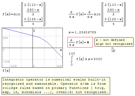

... in Smath 5346 there was another type of common error from plot or from =
"1.23456789987654321" [just to exemplify]
It meant the function could not be plotted/evaluated at this value(ssss)
For other demand, it would evaluate. I din't notice this error message 6179.
This type of error, Mathematica called it "Shadow in Context", giving a list
of values it couldn't evaluate. In other words: "Shadow in Numerical Context"
