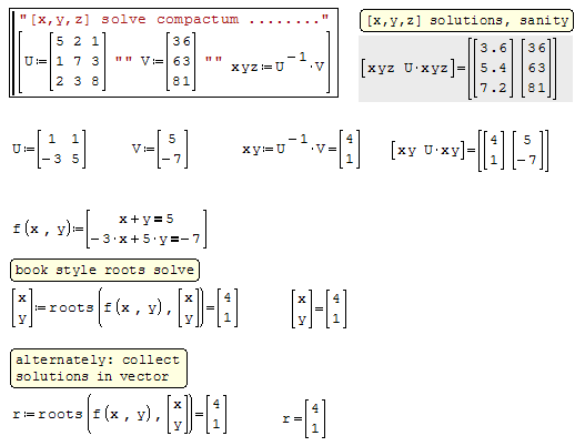

Hi, I am trying to solve this equation
Equation
How can I use the solve(2)/solve(4) function for this?
... like this, simply ... two most direct methods.
Not a case of solve(2), solve(4).
There are more methods than in the attached.
Observe the so much from so little
Solve [x,y,z] Compactum.sm (92.99 KiB) downloaded 962 time(s).

127 likes in 342 posts.
"solve" is only for one-variable functions. You can use "FindRoot" or "roots" as in the attached example solve.sm (6.38 KiB) downloaded 1185 time(s).
