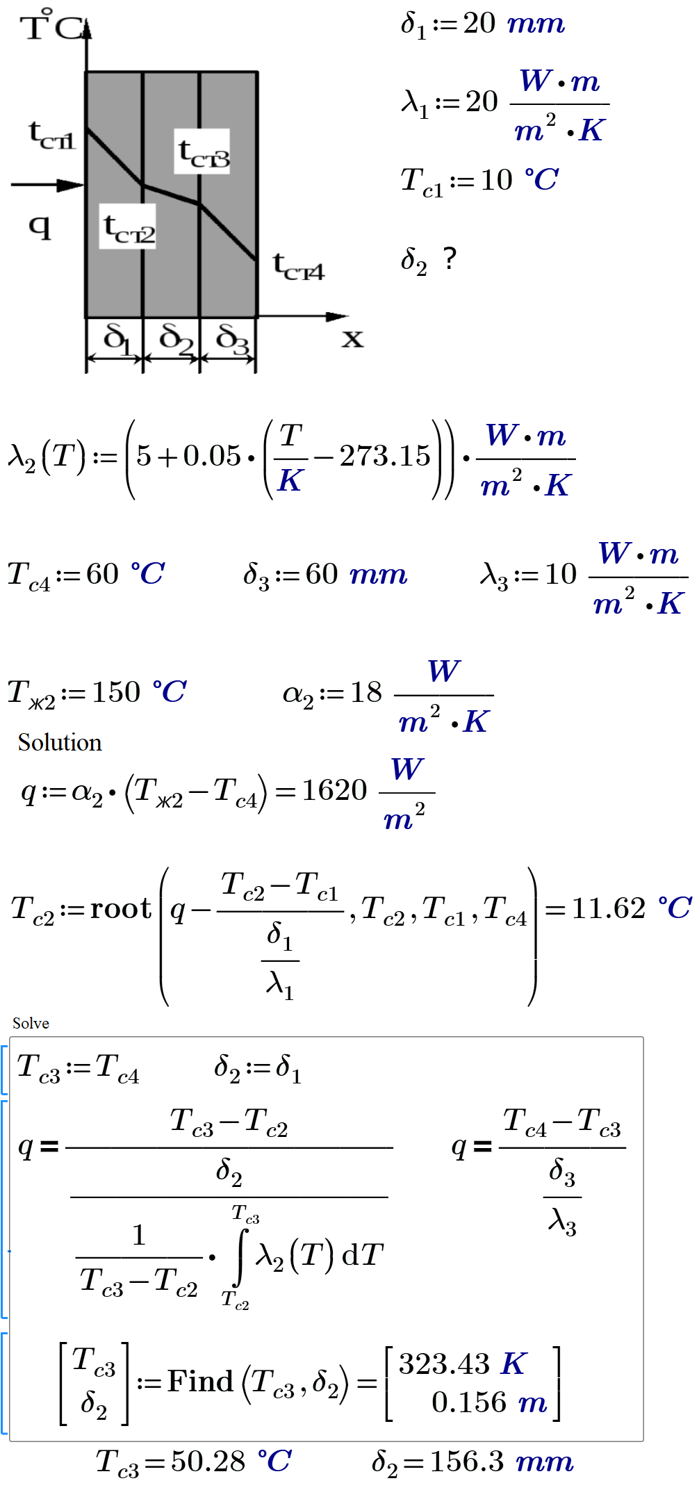

I can it solve in Mathcad - see please mcdx and pdf files
I try solve it (heat transfer) in SMath - see sm file
Help please

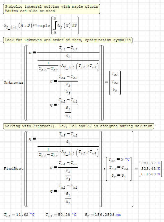

SMath symbolic solving of integration is not capable as Mathcad.
Thus integrals can't be used with numeric solvers.
However, you can use a little trick to solve them.
Using maple or maxima plugins is the key.
Here is your problem solved with various ways, roots() and Findroot().
solvewithunits.sm (23.4 KiB) downloaded 1272 time(s).

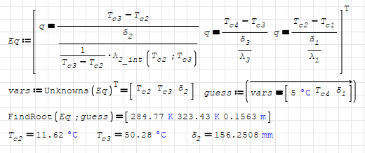

Actually, you don't need to find Tc2 first hand.
Findroot() can solve with all three equations at once.
All important is the order of unknowns.

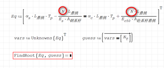

Please help, why can't find root for this simple equation?
root.sm (20.2 KiB) downloaded 1236 time(s).
Because there aren't unknows

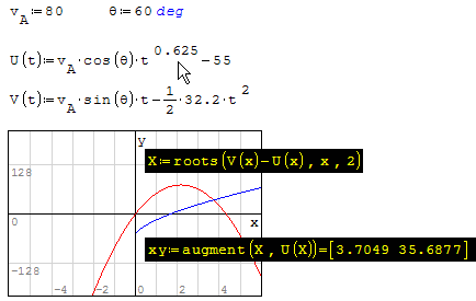

Please help,
why can't find root for this simple equation ?
roots solves wrt scalar function(s)
In this example, both functions are scalar wrt 'x'.
Try ... roots[(sin(x)-Gamma(x),x,1]
'x not defined' ... Gamma(x) is not scalar wrt 'x'
Few more numerical functions are not scalar
erf(x), erf(x,n) ... erfc(x), erfc(x,n) ...
#12 Posted: 6/26/2023 8:55:02 AM
In that case and similar ones,
RootSecant algorithm will spits out 15 decimals, instantaneous.
Cheers ... Jean.

Thanks Davide.
Now I put "N" as unknown in the Eq. But it can't be solved either.
root.sm (19.41 KiB) downloaded 1219 time(s).

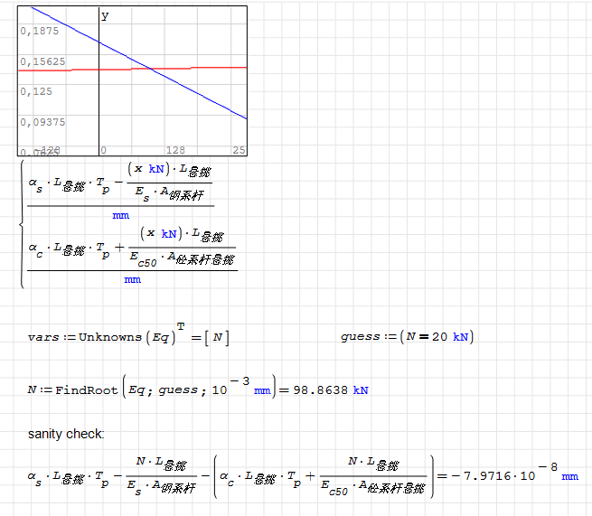

#14 Posted: 6/26/2023 10:58:58 AM
1,443 likes in 2,935 posts.
You have to play a little with the precision, especially if there are units involved; in this case, seems that 10^-3 mm is a stable target (10^-2 works too, but in some case it returns the guess value, meaning that is "close enough" for the algorithm - you can see in the plot that 0kN to 200kN is in +0.02/-0.02mm range)
root_r1.sm (24.03 KiB) downloaded 1276 time(s).
netsonicyxf 6/26/2023 12:18:00 PM
