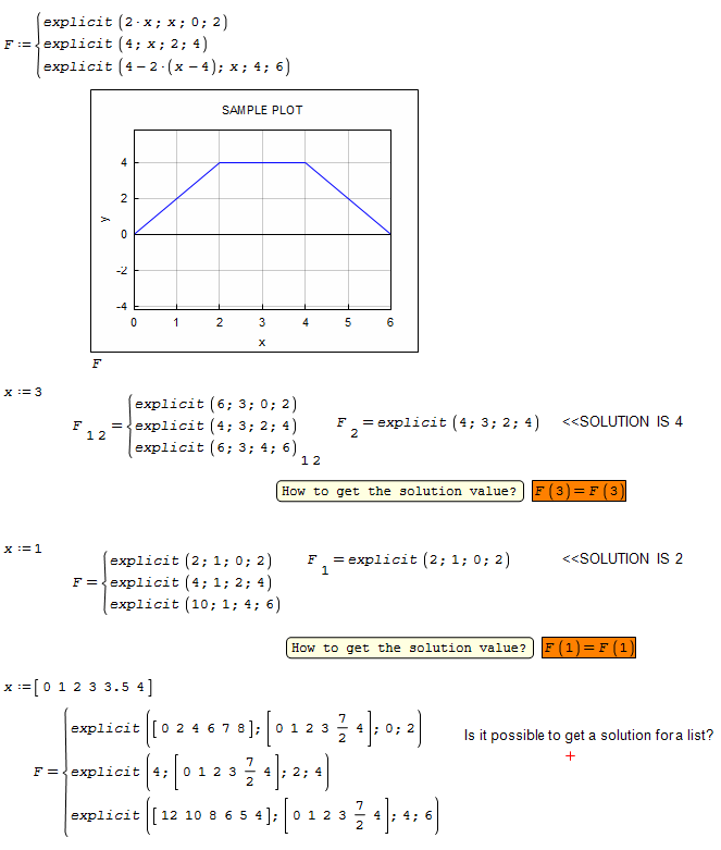

Hello, could you help me?
is there a function in wxMaxima that allows extracting solutions for a composite function?
Hoja de trabajo13.sm (23.87 KiB) downloaded 1563 time(s).

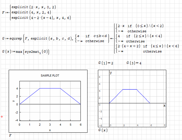

Why not simply:
oscar mauricio 9/10/2024 8:10:00 AM

Thanks @StvMath. The proposed solution is more appropriate for the proposed example, the question was asked in a simple way so as not to present a complex code to whoever could help me.
I need to give a solution to the question because I was analyzing a code published by @mkraska years ago, the code described is more complex and requires a solution with the Maxima plugin. I am also interested in learning Maxima and I think that the solution written by Martin is a very useful way to develop some functions.
"https://en.smath.com/forum/yaf_postst2447_SMath-For-Engineering-Calculations.aspx"

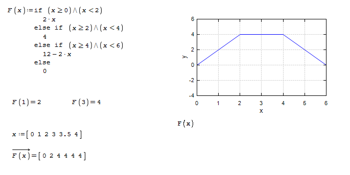

Hi. This could be a way.
Hoja de trabajo13.sm (28.5 KiB) downloaded 1648 time(s).
