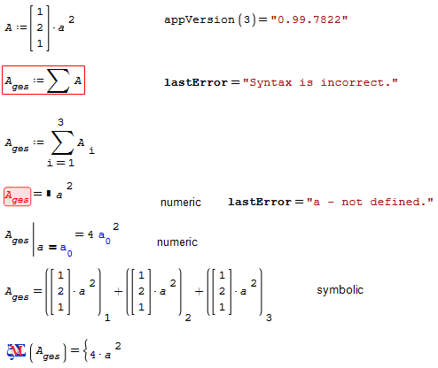

What is wrong with the innocent use of sum(1)? I expected to get the sum of all elements.
Also, the complaint of "a not defined" doesn't make sense, when the numeric value after dividing the result by the unit is pure numeric.
sum1.sm (8.67 KiB) downloaded 1607 time(s).

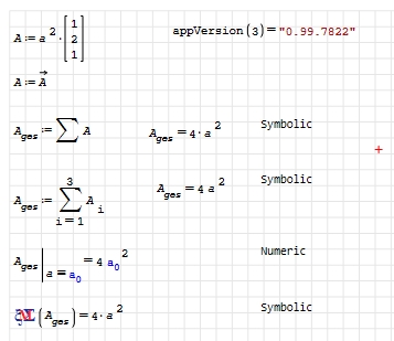

Hi Martin. "a" is not assumed as complex, like in maple, thus don't populate across dot products. (I remember some comment from Andrey about that somewhere). You need to use vectorize.
But ... (always there are one but)
Finally, units are assumed as reals, even it could be remains undefined:
sum1.sm (14.52 KiB) downloaded 1530 time(s).

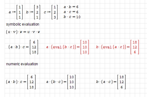

At times I forget the survival rule "don't trust symbolic evaluation"... Too bad that it is the default.

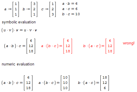

If undefined variables were assumed to be non-scalar, then simplifying (a*b ) *c to a*b*c would be illegal.
I am aware of using units as an enabler of universal happiness. Yet,usually they are pre-occupied in an un-clearable way with some content, which makes it awkward to use them as symbolic variables. That's why I use 'a.0 instead of just 'a in the above example.
It is a pain to explain these things to students.
Worksheet3.sm (9.8 KiB) downloaded 1570 time(s).

As explanation for your students try to show that in other languages you need to introduce another operator for vectorial (or matricial and tensorial) products: https://reference.wolfram.com/language/ref/Dot.html . In mathematica Dot operator is {a}.{b}, not {a}*{b}. Also in old maple versions, whith linalg, you need to call evalm (eval for matrices) for actually do matrix operations.
Are you aware of any programming language which produces the same rubbish (the above (a*b)*c example) without warning?
I present SMath Studio to the students as a means for performing and documenting engineering calculations. I try to avoid problems which I would not have without SMath Studio.
Yet, some problems can't be avoided, as they are related to physical understanding, just like the units of temperature and change of temperature or the difference between angular velocity and frequency.

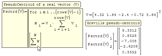

#9 Posted: 7/1/2021 7:38:14 AM
What is wrong with the innocent use of sum(1) ?
Sanity code Greville Pseudo-Centroid.
