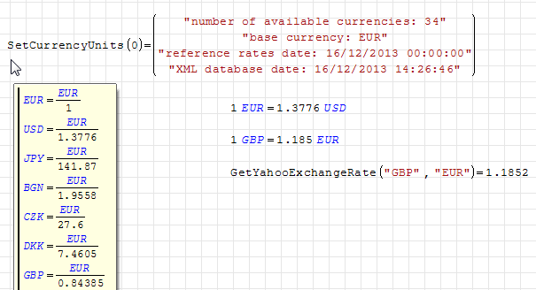

Here there is a plugin to have currencies and exchange rates in SMath Studio.
Infos:
Functions:
  • SetCurrencyUnits(1), SetCurrencyUnits(2): extends SMath Studio with currency units. When an internet connection is available, exchange rates are kept updated using the ECB reference rates (internet connection not required but useful);

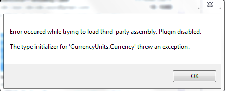

Unfortunately Davide, this does not work for me (Win7 x64). Plugin refuses to install properly.
#6 Posted: 12/17/2013 8:07:23 AM
1,443 likes in 2,935 posts.
ok... as for now the password is: TEST
Better now, but still no connectivity. I guess that is sort of firewall or proxy issue.
Try again, I've made some changes... If doesn't work try NetTest(0) and NetTest(1) and post a screenshot
very strange... try again with this update; if doens't work got to %APPDATA%\SMath\Debug\CurrencyUnits and post the log file

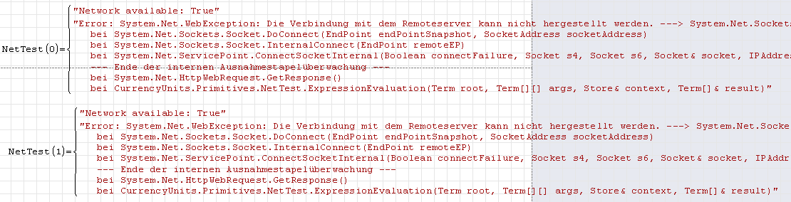

The results were overly wide, thus i cut them.
#8 Posted: 12/17/2013 8:41:47 AM
Failed again
Here is the log file
log.txt (1.76 KiB) downloaded 1401 time(s).
#9 Posted: 12/17/2013 11:09:29 AM

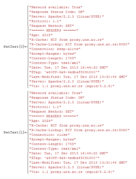

seems a proxy/firewall authorization problem... I suppose that NetTest("http://www.google.com") and NetTest("http://www.google.de") will produce the same results
Failed again
I've made another little modification, could you try again?

It seems that this plugin is not going to install into the Martins' unofficial build. I figured out by the second line of the log file.
I tried it on the official one and it seems to be Ok
Davide Carpi 12/17/2013 1:50:00 PM
#11 Posted: 12/17/2013 1:52:02 PM
thank you Radovan, now I understand
the plugin looks for the files in the %APPDATA% folder, I'll try to fix it
[EDIT] UPDATED: this version should work properly both in the official and the unofficial versions

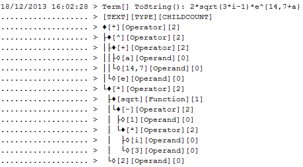

UPDATED
- error handling: LOGs will be placed in the relative "extensions\debug\CurrencyUnits" folder (so the portable version has a portable debug path)
- For developers only: added a log tool to output a Term[] tree representation (see the CurrencyUnits Implementer.cs).
