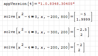

Very strange behavior.

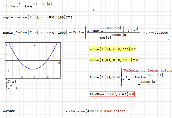

Hi Viacheslav. Numerical procedures: You can always find examples where they fail. I find this variation of your example particularly worrisome since the function changes sign in the interval where the zeros are requested. It seems that it takes as a tolerance something proportional to the width of the interval
It is true that apparently the SMath algorithm can be improved in several ways. However, something good must have. Here SMath succeeds where Maple, Maxima and FindRoot do not.
I may have written about this bug long time ago.
Solve Calculates Different With Different Ranges
